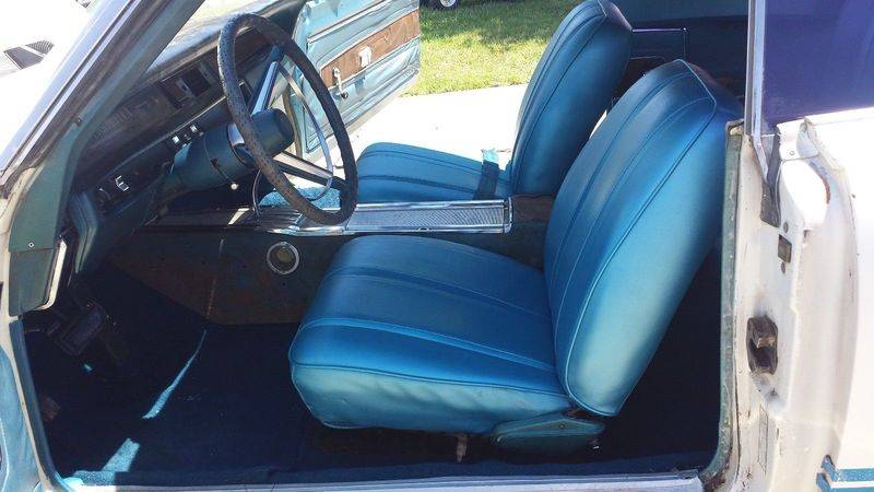

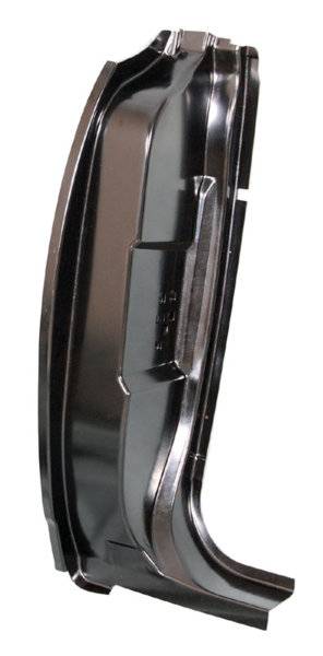

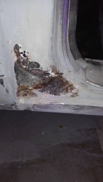

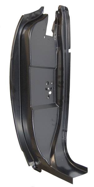

I've got a 70 Roadrunner convt. & I need a patch for the passenger door jamb. I just need the lower corner & maybe part of the rocker panel outer skin. For the door jamb, AMD only shows a hardtop & a post/coupe version (no convertible) AND the two pieces are different. Does anyone know which piece I need to buy to patch my car (just the lower corner)? THANK YOU!

Left = my convertible
Middle = Post/sedan
Right = hardtop
Need a picture of your jab further away. A vert is a hardtop with a removable roof,
Hey Richard, now that you post a picture of a convertible door jamb, I can see I need the HARDTOP version of the door jamb. The coupe one (post/sedan) doesn't have a notch in it for the rear quarter windows to roll up/down......duh (I should have seen that before).
You're right, no notch for the "brass convertible striker" isn't there.....but as Fran noted, I'm only going to use the bottom part of that patch panel. THANK YOU GENTLEMEN!!!

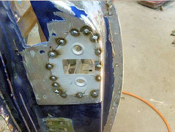

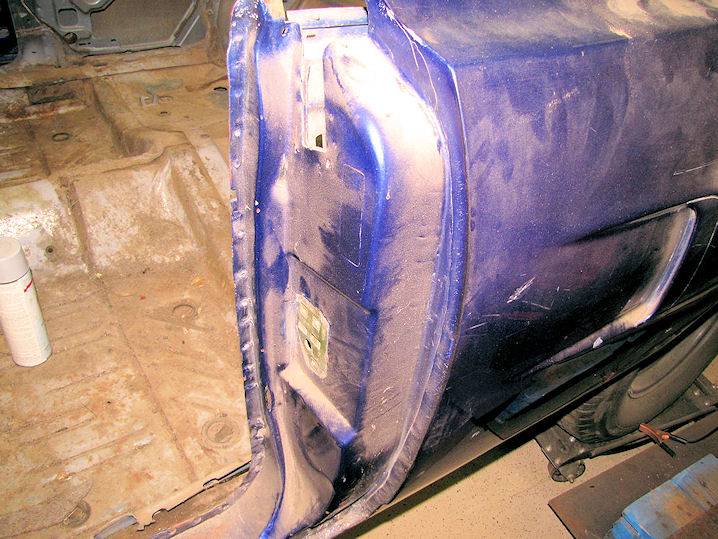

On my 70RR, PO had replaced driver door and jamb with hardtop metal from green Satellite (bondo'd door molding holes). Didn't bother to replace striker assembly (on door or jamb). Fit good but that was with orig metal. I found a 70 Coronet vert in junkyard for jamb transplant.

Nice 70runner, but I only need the very small piece at the bottom corner (thank God), so I ordered the hardtop door jamb from AMD to cut a patch out of. THANKS EVERYONE!
