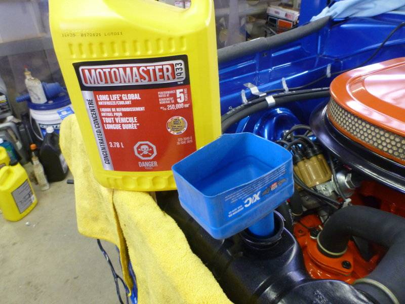

Buy a spill free funnel. They work great. Pull the temp sending unit out of the engine and add your coolant through the funnel slowly until it comes out sending unit hole. Replace sender and continue adding coolant until it backs up into funnel. Run engine to burp air until t-stat opens and both radiator hoses are hot, adding coolant as necessary to keep level just barely in sight in funnel. Kill engine, let cool and remove funnel. Recheck level in radiator. No variables this way.
Perfect funnel.. top off an oil bottle.
