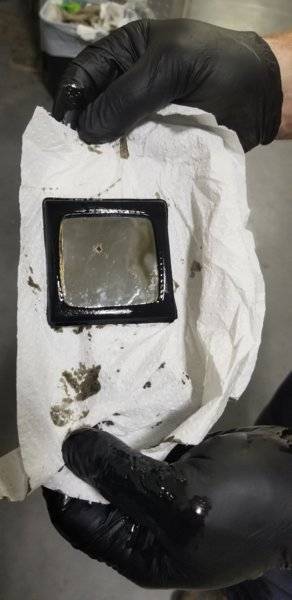

    So 2019 keeps bringing 1 surprise after another. About 3 weeks ago I put my semi in the shop to receive a new head. Coolant had been leaking through the injector cups. So $10000 later I'm rolling again. Today all the bells and lights start flashing and back to the shop I go. Coolant is back,this time it took 2 of the 3 filters in my DPF system. Pulling injectors to figure out which cup is leaking coolant we find this.

    Out of shop this morning, they found coolant under #3 and 4 injector. So he drained as much coolant that he could. Now off to the 1st shop for a visit from a very unhappy customer.

        so you think the mirror was the issue? why did you not go back to the original shop in the first place? Ill never understand why people have something fixed some where then there's a problem with the work and they go to another shop. again why didn't you go back to the shop who did the head in the first place?

        I am going back to the original shop. But to save time I had it diagnosed at another shop to justify leaving a $6500 load and bobtailing 500 miles back.

          As far as the mirror goes, when You're paying $150 per hour you don't expect to find things in your engine that don't belong.

            Roger63 are they just replacing the orings in the injectors. I hope not found issues with injector cups the pressure on the injectors keep in creasing have found several cracked cups. Pulled old ones out installed stainless steel ones problem solve. Also found bad orings from factory install and have replace head.
