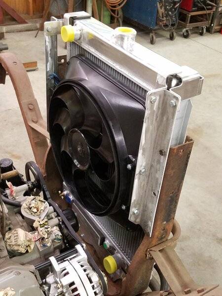

Im working on a 1941 power wagon project. I put the cab and box on a 1977 dodge 3/4 truck chassis with a 400. Due to the front of the engine compartment being small the radiator i'm forced to used doesnt seem to be able to keep the big 400 cool. I have two electric fans, one on the front pushing air and one on the inside pulling air. I bought the largest radiator that would fit. Would switching to a small block help? I know i could mount a large radiator in the box and plumb in hoses but I really dont want to. Thanks in advance for any help.

I'm running a 440 under similar circumstances.
I, like you, have 5" of clearance between the rad
face and WP. I installed a 3000 cfm puller from
Summit that has an included shroud, a 185
deg T-stat, and a 3 core aluminum down flow
w/water wet.
I'm also running a 727 with a 2800 stall conv,
and a fan cooled remote mounted trans oil cooler.
During cam break-in, she never got above 190.
Thought I'd add part/manufacturer numbers
if you think it would help. If you're thinking
about trying a high volume water pump, be
careful and match the volume of coolant
typically for a 400. Faster flow will reduce
the time the coolant is in the radiator, and
may add to the heat problem.
Radiator: Speedway Motors # 9175159
Fan: Summit Racing # FLX-168
Sure hope this helps!
