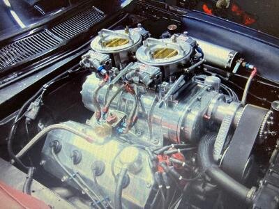

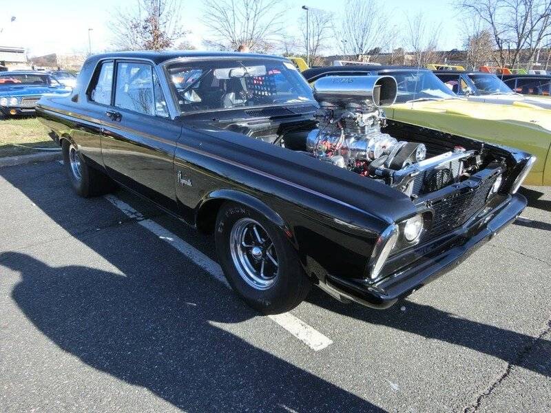

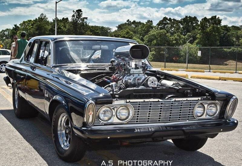

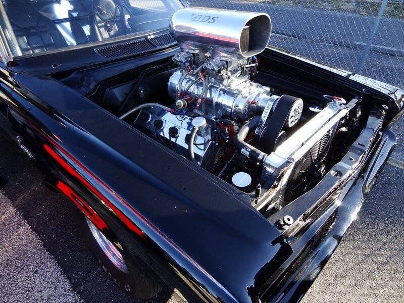

Running a single spall pusher. $200 Afco triple pass aluminum radiator. Keeps my 545ci around 180/185*
11905389_866995506725309_2093365551932066056_n.jpg thumbnail (10).jpg thumbnail (21).jpg
