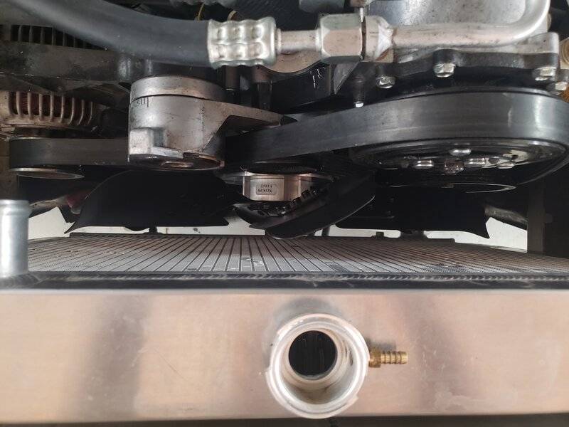

1967 Coronet, 383 stroked to 496. 26" 2x1-1/4 aluminum core. Flowkooler water pump, robert shaw 160 n 185 thermostat. Serpentine pulley setup w reverse rotation water pump. W 2 electric fans 12" n 11", aluminum shroud w 10 additional 2" holes in it for highway airflow, it idles at 192° in 112° outside air temp w a/c running. But on the highway at 60+ it gets to 220 on flat n level. Changed to Derale 18" non flex reverse rotation direct mount fan w factory shroud. Idles at 228 w a/c on in 114° temps. Haven't gotten it on the road yet to see if it will be cooler at highway speeds. Any rpm above 1400 n trailing edge of fan blade nicks a/c compression rivets. I have a 1" spacer. The fan is perfectly 1/2 in 1/2 out. If I move it 1/4" forward, it will hit radiator lower tank. Definitely not happy w idle temps compared to electric. And the fan touching the a/c compressor is definitely no-go. Any suggestions? Lightly bend traing edge of fan at area where it hits a/c compressor? Before someone asks timing, a/f ratio etc. Everything is dialed in. "Only" issue is temp at idle w mechanical fan and touching a/c compressor. Thank you
Personally I’d remove the reverse rotation pump assembly, start over. Also sometimes too much flow is just as bad as low flow, what was the condition of block and heads, over bore? I’d also try a different radiator, it’s sounds like you have saturation at low and no speed, the reason I said the radiator is how well does the air/ water flow thru it? Just for sanity and I know you said it’s dialed but air fuel and time if are spot on. Look at the basics, if nothing else remove and put it on a run stand ... this thing isn’t crazy tight is it? Isolate things one at time, see if you can locate parts that are known good from a friend ... you are probably staring right at it and just not catching it... we’ve all done it so just relax and be patient... AC adds about 20degrees while running to the cooling system. Also I would not bend a fan, it can cause balance issues or fatigue and with it spinning like crazy that could be ugly..best of luck keep us posted. Post some pics so we can help visualize what you have especially the ac.

AFR 13.4:1 at idle. Fuel injection. Timing at 32° at 850 rpm w manifold vacuum. "I will not get into 'theories' of vacuum advance. Again, with dual electric fans at idle w a/c on using flowkooler water pump and both a 185 n 160 thermostat, the engine can idle for over 30 minutes waiting for an accident in 112° temps and stay at 196ish. And at slow speeds it stays below 200°. I'd rather not throw away 1,500+ in accessories n brackets and find all new brackets n accessories for standard rotation.
Do you have a picture of the shroud used with the mechanical fan?

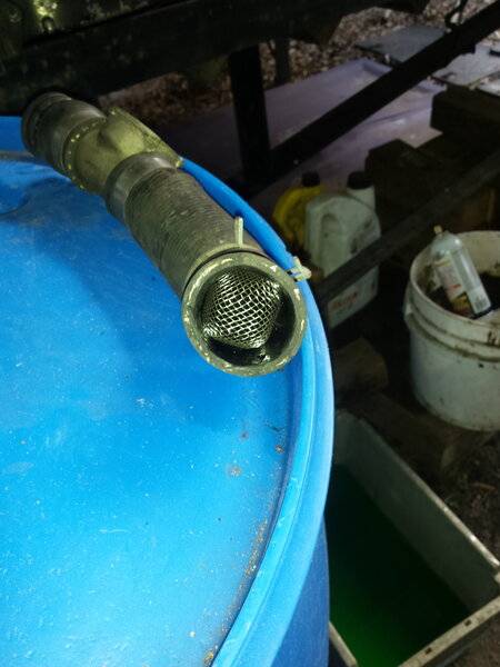

A cooling system filter screen screen can keep a new radiator from clogging. When crud / debris works loose from an old engine it's tough to get all the nooks and crannies in the cooling jackets perfectly clean. Which might be your problem. I Use screens in all my vehicles and have to clean them out when I see the Temps start to rise.

Freshly rebuilt engine. Have flushed it twice "just in cass", no debris and fluid is pretty green.
