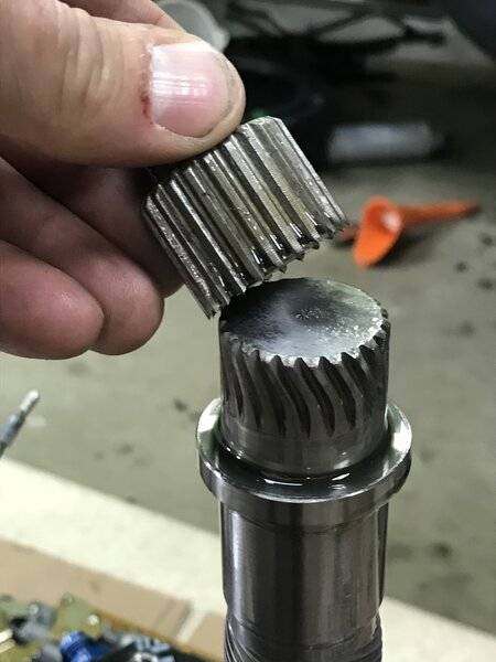

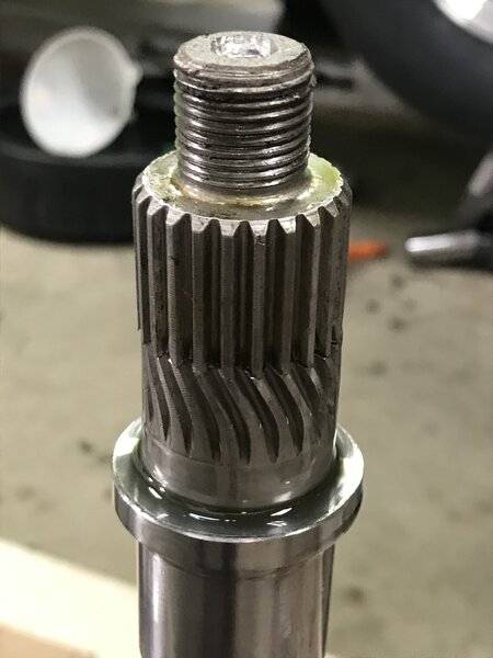

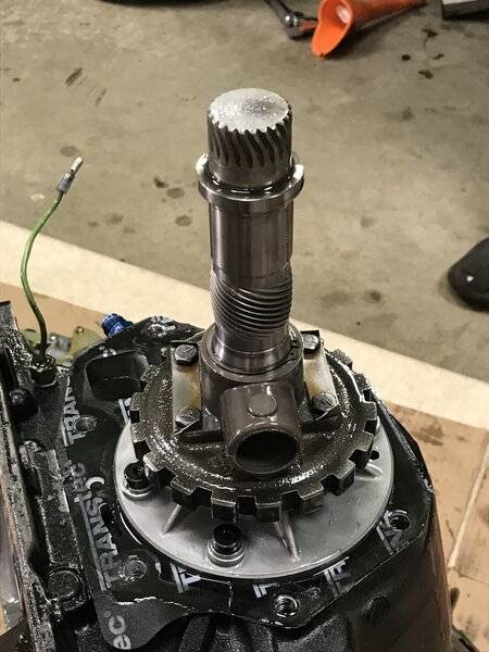

The output shaft doesn’t like the second gear shift with the tight converter. Ordered a new converter and this valve body. It should be interesting...

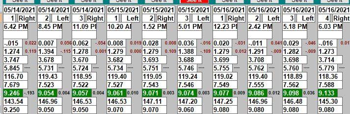

Consistency with 10.53 SLR. Last time out 10.5 tire, foot brake with starting rpm set by tach (no starting chip), no air shift. Runs #2 /#6 60 ft was with the rear tire. Run #1 throttle was set at 3/4 open to test 9.25 index run. Last passes the engine was wounded and fell off .02 then .05
