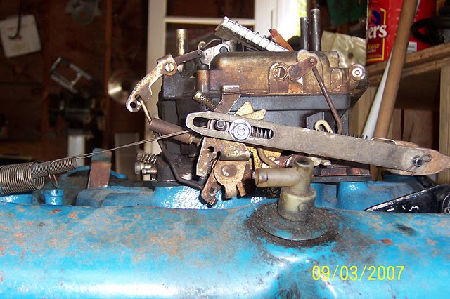

On the intake, there was a riveted thin metal oil sheild that was on the intakes bottom.
Scotts tail light horror story comes from broken plastic retaining studs. Do not over tighten them after a bulb replacement. For the 4bbl. hook up, dodge41969 has the right idea, the tranny kickdown rod is different than a 2bbl. though you could make it work with a small bolt and nut with a washer on each side of the 2bbl. rod.

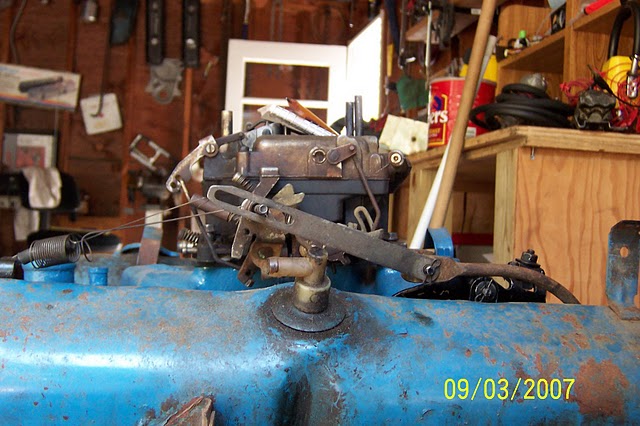

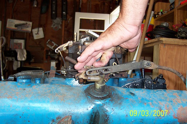

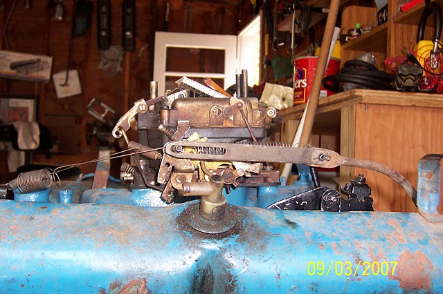

Below is a couple of pictures that should help .
This is a T-Q (Dirty bugger huh?!) with the 2bbl. kick down rod. The rod will flop over foward. It has excessive play. It will lean to far foward.
The 3rd picture shows the 2 washer, nut and bolt set up I & (maybe) dodge41969 was talking about. IMO, you should use a nylon lock nut. This will allow you to tighten the nut on the bolt without having fear of it slipping back and forth. It also does not need a lock washer to keep it in place.
Idealy speaking, the last shot shows how you wnt the rod to end up, nice and straight across without the pivot point at the rear of the intake to far foward so it doesn't bind up. To adjust tranny kick down, the nut and bolt can be slid for and aft.
If you can not get it just so, then the other tanny adjustment point is at the bottom of the kick down rod. The rod goes through a square block and that block has a nut to lock down the rod at a set point. Of which you can adjust, of course. This block is on a lever on the trans.
