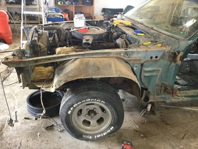

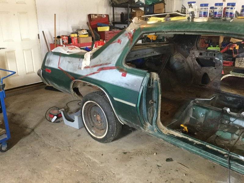

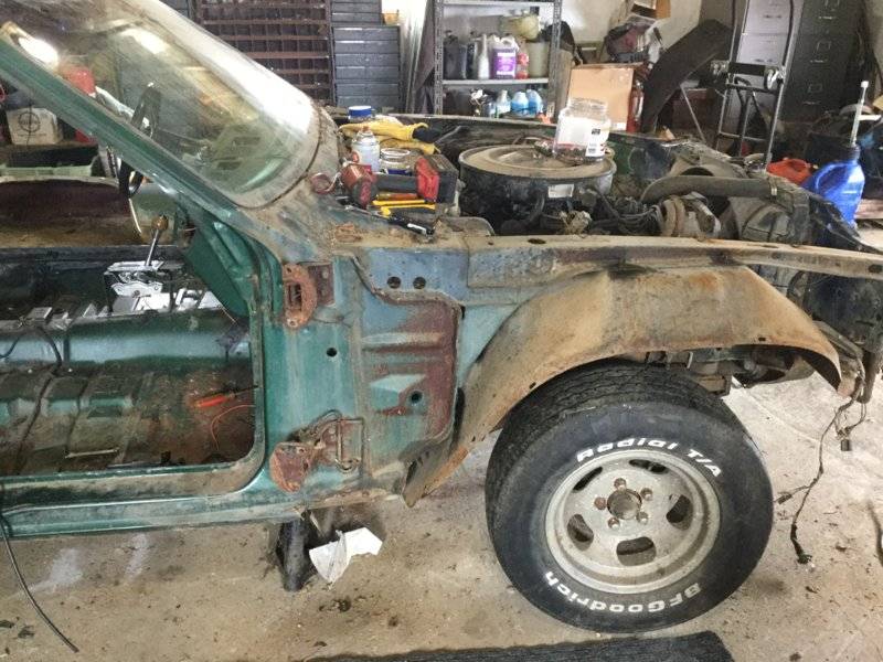

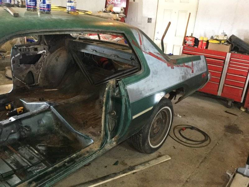

With time off do to Corona virus started into my 75 after 20 years in storage. Body a lot better shape then thought with minimal rust for a Canadian car eh. Was brother in law’s till passed away, he bought most of chrome trim, decals and emblems before being discontinued. Having trouble finding rear defroster glass as it broke in storage, local dealer part number saying only in 1975-78 Fury,Coronet, Monaco. Different numbers for Cordoba, Charger of same year. So if anyone in Western Canada knows of mopar wrecker or similar would be great to get info. Car was in accident earlier in its life, drivers side, terrible repaint and repairs cheap. Noticed LH front fender not sitting right, now apart possible frame has twist, have to find info on measurement. Finding lots of info on this Forum, so thanks guys for all the info.

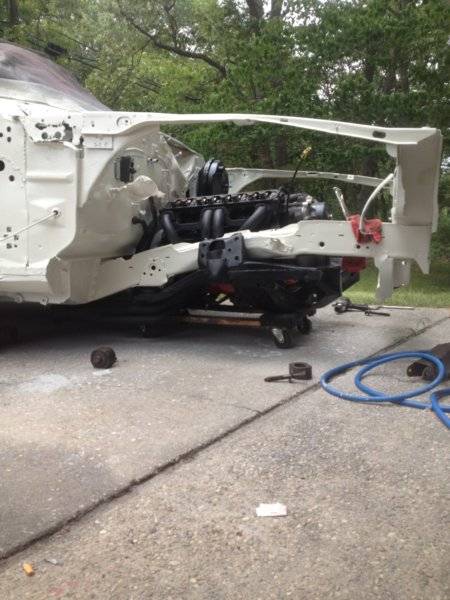

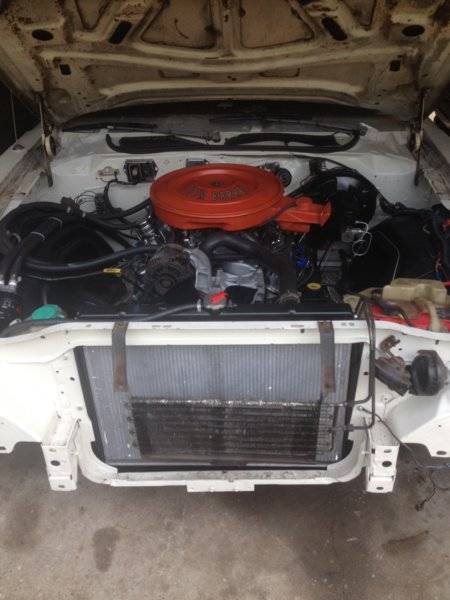

View attachment 937045 View attachment 937046 View attachment 937047 View attachment 937048 View attachment 937049

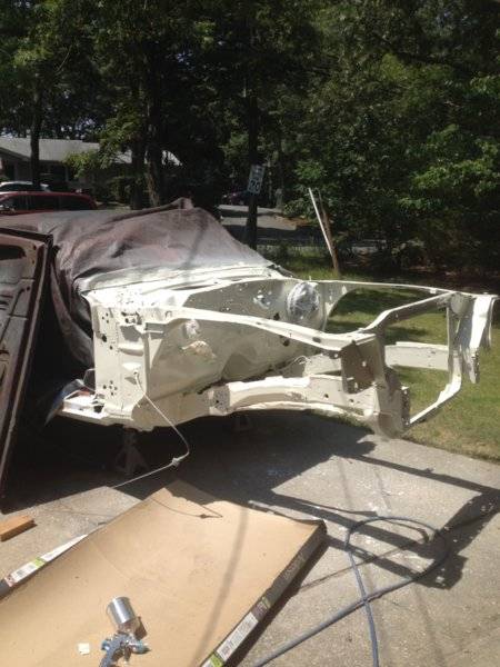

Looking at your top pic, did you add support support from firewall to frame?
Thanks! Lots of sourcing out parts, big price differences from local venders have to check everything, crazy can get 50% differences. Online really have to watch shipping costs. Where you at in BC?
sent you a PM
Nope, that is the way the factory made it and no additional work was done. I patched up some rot that was surrounding the door hinges. Fought it down to bare metal, primed and painted it the OE “Spinnaker White.”
Awesome build your doing. I like your bumpers got me thinking instead of rechroming make some light fibreglass. Have to get mine in air to see what you did on your rear suspension. Those stock springs just relocated?
Thank you! They are superstock springs. They are STIFF. i may end up pulling a leaf out.
The fiberglass can be fun but time consuming. If these cars didn't have such goofy angles, I would have just slid the OE bumper shell in...But that looked even goofier.
