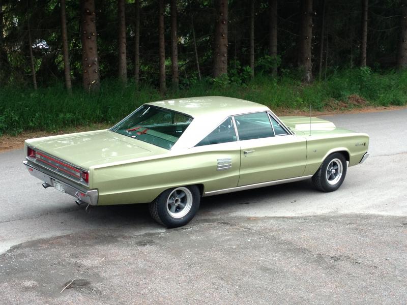

Stroked 400 to 499
eddy rpm fullported heads
eddy rpm intake
holley 850hp
comp cam XR292HR
Hughes roller rockers 1,6
1 7/8 headers 3 collector full exhaust 3 x pipe
msd 6
3000rpm converter shiftkit stock valve body
SS springs
3,55 8,75 rear
best 10,98 124mph 60foot 1,68
All steel car and legal street car

Wow. That's a beautiful car. Nice job!

Killer car. What's that chain hanging from your rear passenger corner?
Thanks. Its for the batteri switch

nice car & sounds like a nice comb too...
holy sheep **** is that a nice looking car thanks for sharing ,we are **** addicts here post some more :headbang:
