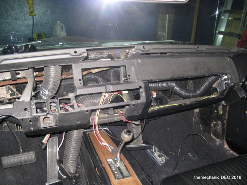

You can remove the pad without removing the metal dash frame. But it is easier when everything else is out of the way. It is a process but pays dividends for a long long time when the result is a new looking dash.
Thanks much! I spent some time today taking most of the stuff out of the dash so it currently looks pretty much like the photos you posted. I'm dangerous now!
