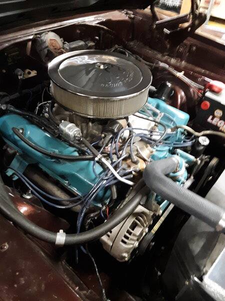

My 67 is a original small block car with a transplanted 440.
I have a edelbrock performer intake with a thermoquad carb. 14 x 3 air cleaner with a drop base.
I have 1" of clearance ( measured).
If I was to add a spacer under the carb ect. I would switch to a 2" filter.
My air cleaner is just a cheap chrome summit one the top lid is concave up.
A guy could purchase a flat aluminum lid and gain close to one more inch of clearance.
