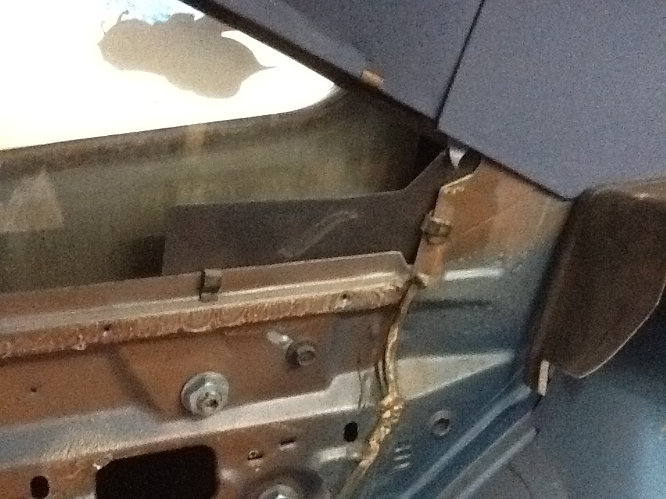

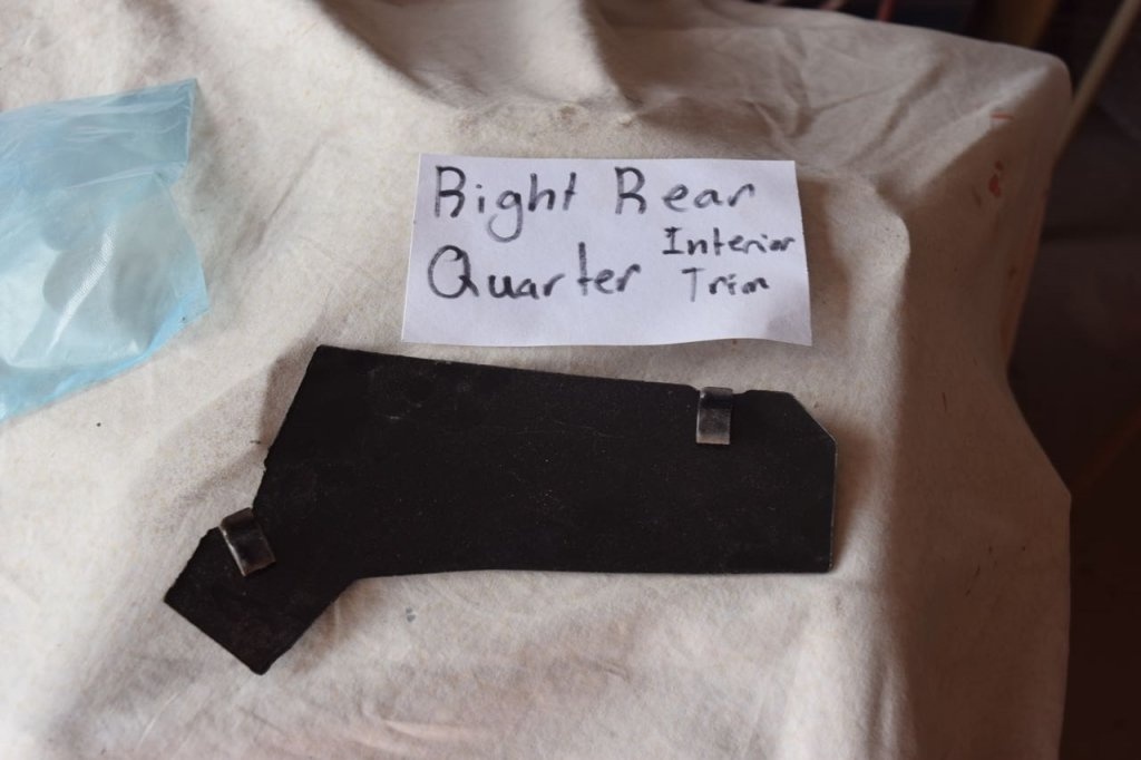

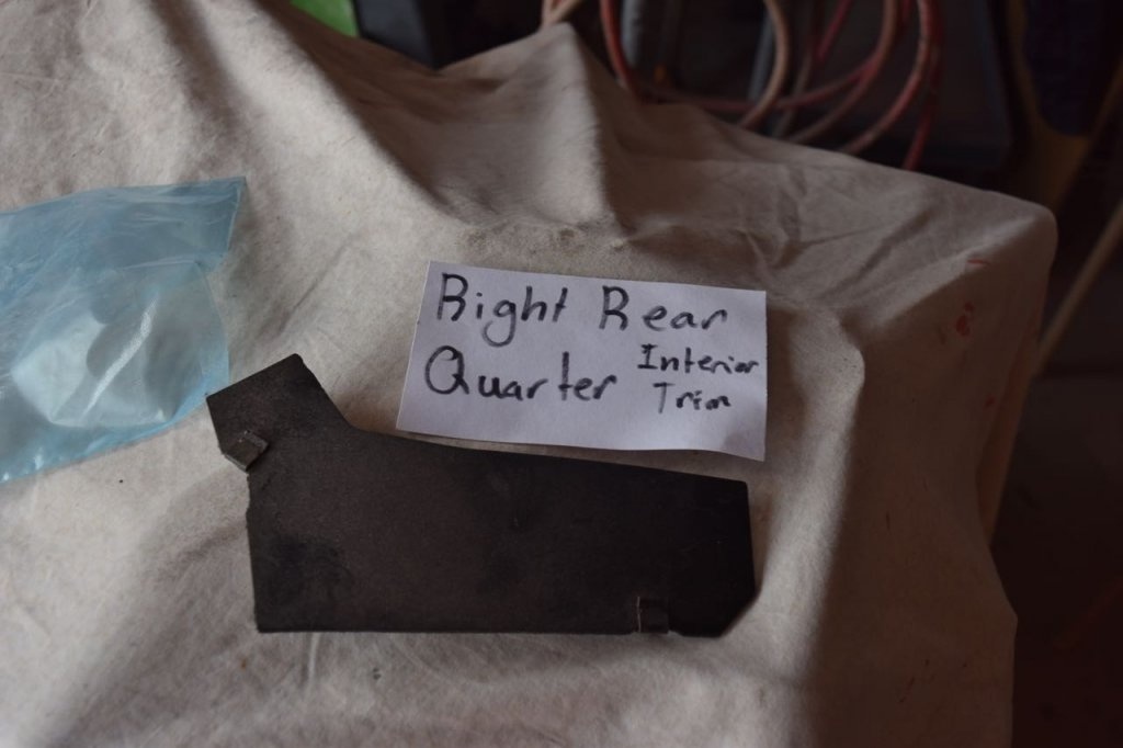

I need help assembling again
. It was obvious when I removed it but where does this go? My note to self was not enlightening..
1968 Coronet 500..
It goes on the rear of the quarter window opening on the inside sheet metal at the rear. Board goes in side the window opening and the two clips slide down on the inner sheetmetal top edge. Dog leg goes up and to the rear
That would help. I am trying to picture it but failing. Is it visible assembled? I am not seeing it on the reference photos I took either.
No it's not visible once the rear upper interior panel is installed.
Ah-ha I don't really remember taking that off but this answers it. Thanks.
