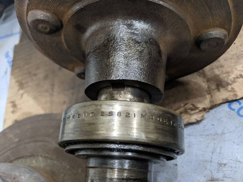

Anyone out there know what the correct part number is for the axle bearings on a 63 Dodge Polara with original tapered axles
I tried checking with Timken and Yukon but no one can tell me this info
I have a bent axle and need to replace bearings first then check out the carrier bearings in the rear. Got a grinding noise and wheel looks a little wobbly when spinning off the ground
Thanks
Fred
Timken # 25821, Made In Canada, shown in a picture of one on an axle in the shop. Jeff J
25821 is the race (cup) number. 25877 is the bearing (cone) number
