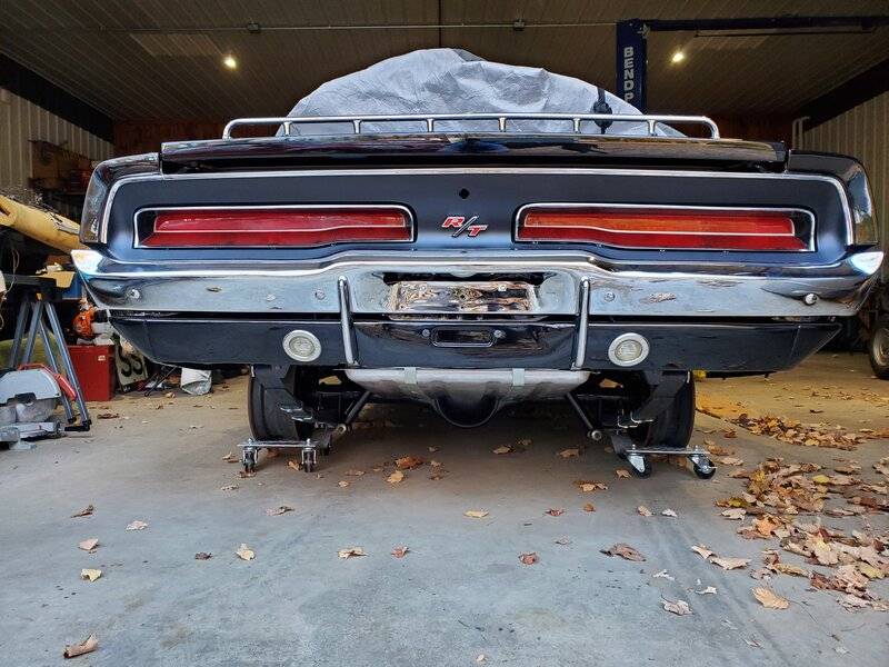

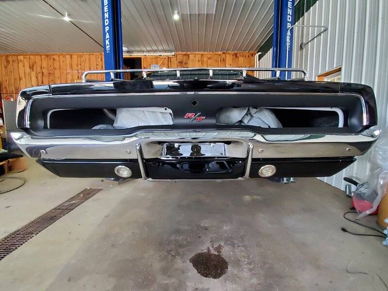

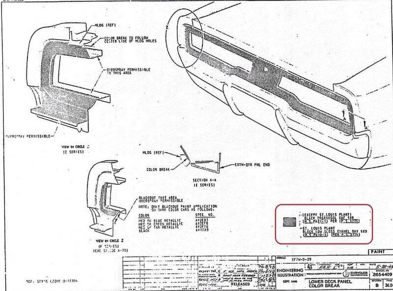

In the Factory service manual, and some other books, I have found the correct paint coats for the body color,(in my car F5 2024Ditzler/4987LDupont) and the dash color, the top of the door panels and the window trim, even the engine paint and the air cleaner paint codes, and even the correct amount of gloss or flattening /suede needed if any)
But I can not find the codes for the black rear tail light panel.
Anyone have the correct PPG, DuPont or ditzler #'s?
