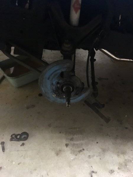

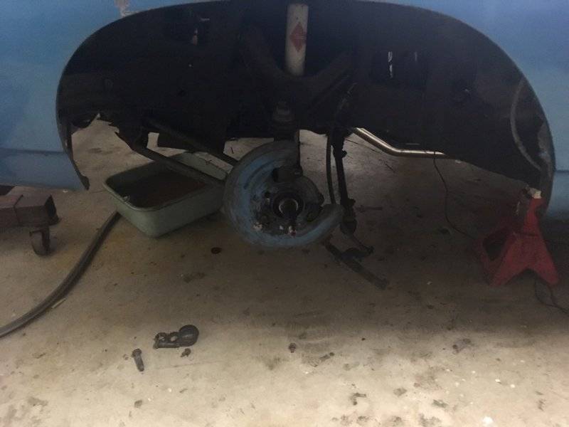

Hi, I was wondering if I could get a recommendation to the correct size front rotors I need for my 68 RR? We are changing the front discs and can't seem to find which size we need on Summit. I attached an image of the wheel well if it's any help. Thanks!

So you are going from drum to disc? If you took off a rotor then measure the old one. Not sure I follow whats going on.

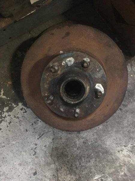

I am just replacing the front disc rotors as the old ones are shot. I have a pic of the old one, but I can't seem to find exact measurements online on the listings on Summit. Thanks
If this car is a factory disc brake car, these rotors are the Bendix style for 66-69 B-body. So you need to start searching or Googling for B-body Bendix Rotors. They tend to be expensive. You can get it in a new 1 piece design or just the rotor, that you have to press out the wheel studs to install on original hub.
Right, if that is an original disc brake car then good luck. You aren't going to find parts on Summit or your local NAPA. The Bendix four piston setup is collector car only type of parts so you have to search around. You might be able to find a rebuild kit for the calipers but I'm not sure if rotors are available or not. They didn't use to be available but someone might be making them now.
If you are restoring the car then you'll just have to find the stuff. If you are modifying the car then pull all of the Bendix stuff off and sell it and just buy a late model A body disc conversion kit from Doctor Diff. You'll be money ahead and the late model brakes work better and are a ton cheaper to service.

It isn't that easy. The rotor spins a set of tapered roller bearings and there is a seal that keeps the grease inside the hub. There is also the bolt pattern and the location of the hub face which locates the wheel on the car. You don't seem to understand how important a front hub assembly is to your car. All of those measurements have to be correct for a replacement hub/rotor to work. You can't just randomly select some parts out of a catalog and expect them to work. You are dealing with some stuff that barely exists anymore. I tried to rebuild a set of Bendix disc brakes 30 years ago and it took me a ton of time back then to find a replacement set of rotors.
