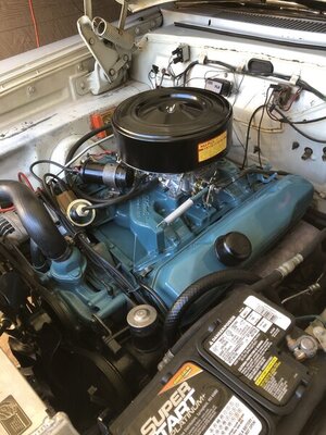

Is duplicolor #1619 Chrysler Green the correct color for a 67 440? It doesn’t look correct.
Should be turquoise. For rattle cans, Mancini has about the best color IMO.

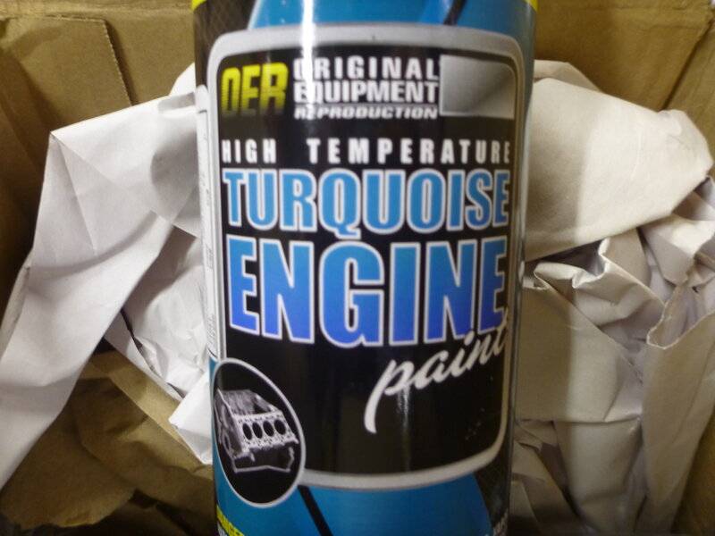

HT SP 126 Chrysler Blue but it’s Turquoise.

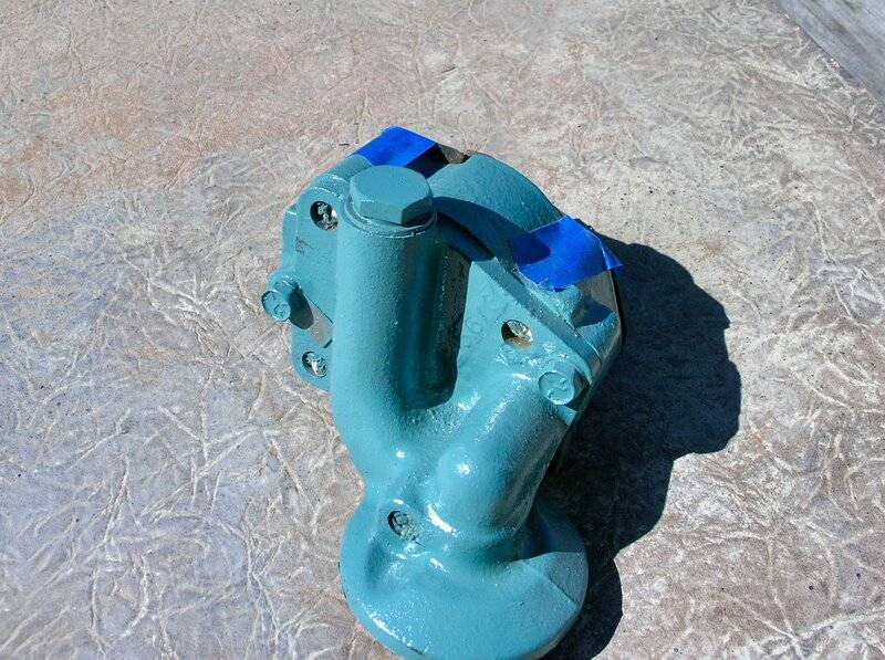

Hirsch claims it's impervious to fuel, but will stain with long term exposure. I use it as the old timers who were doing concourse restorations when I started messing with cars used it. It's thick and brushes on nicely with no waste floating away.

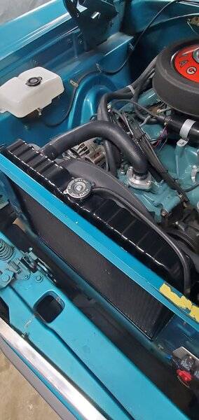

I can vouch for that, painted my engine 4yrs ago and it still looks like I did it yesterday. Have had fuel on the intake once or twice and no peeling or staining...I won't buy from anyone else unless Hirsch doesn't have it. This pic was taken 2 weeks ago, you can see some of the engine!

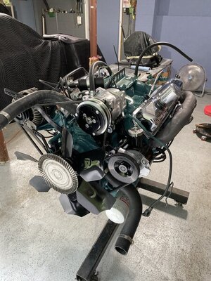

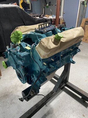

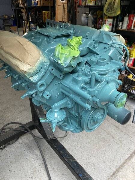

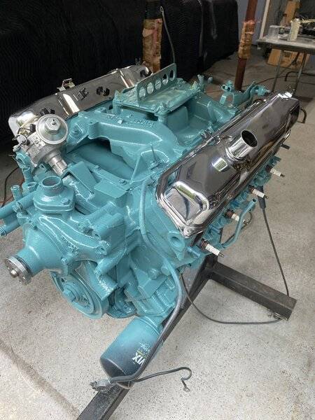

I checked my inventory, I still had 3/4 pint of por15 Chrysler turquoise. Thinned it the suggested 20 percent and sprayed it on. I’m happy, correct color and this paint always flows out well.
2B61B726-757B-441B-B1F8-904542666AA6.jpeg 395BAD12-96E4-438E-BFB5-B77E72D9A57A.jpeg 4E2CA131-7987-4EC5-8837-1EAFF93FF073.jpeg
