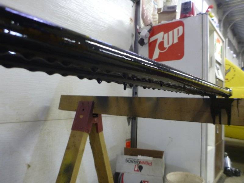

I'll start you off with Torsion bars are Gloss, K frame is semi, steering components were bare forged steel, depending on car line and supplier the upper arms could be bare or black and the lowers black or ...

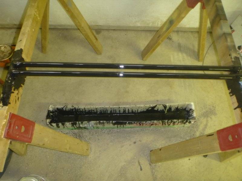

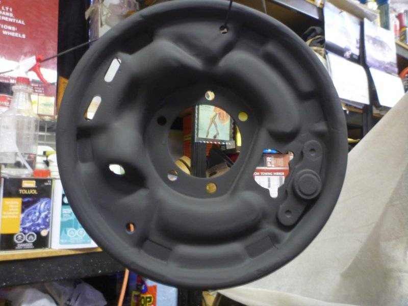

Not sure what year they're talking about ^^^^ there. But 69 sway bars links are black phosphate/bare natural process steel. Brake backing plates are a blackish phosphate colour, not semi gloss black. High heat BBQ paint fakes it well. Torsion bars are DIPPED gloss black.

Torsion bars...

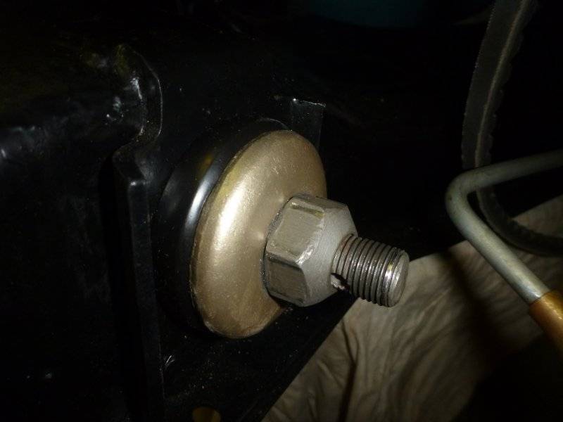

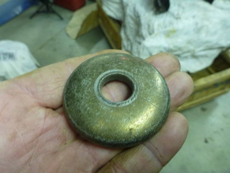

OE strut bushing retainer washer.. If you want to paint Champaign Pearl is close...

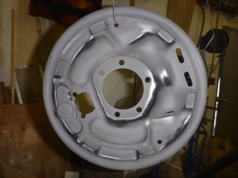

Backing plates
Wet

Drying to a good fake of OE phosphate coating.

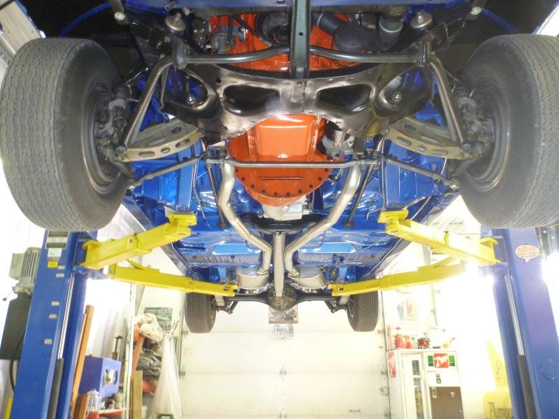

BTW... this is my Bee at it's 200 mile inspection. After 4 Summers on the road... I live on a gravel one.... and about 4500 miles later it still looks exactly the same!
All bare metal parts were coated with RPM (Rust Preventive Magic) from ECS. I did my '69 Dart bare parts with Boeshield T9 and in both cases NOTHING has started rusting and both cars have been out in the rain. This shot is the Dart with the bare stuff coated in T9

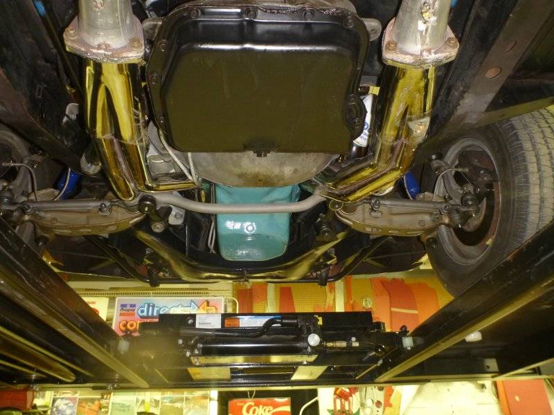

The angle of the light must be bad, but are the Bee’s LCA still in the cosmoline color? The below pic makes them look dirty.
I’m going to paint my LCA in the cosmoline color and hope the coloring holds up. For the ball joints, did you pack them until grease came out? I dread cleaning up parts only to have the grease/crap ruin it. But I drive my Bee a few thousand miles a year.

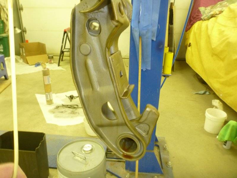

Colour? As shown in the 3rd post they are dipped in the real stuff!
As for greasing, done properly you should never blow grease out the boots.. but if you do wipe it off.

Yes, I know the LCAs were restored correctly, just curious how the coloring is holding up, because in the photo (post #13) they don't look so yellowish anymore. BUT, the lighting could be distorting the color.

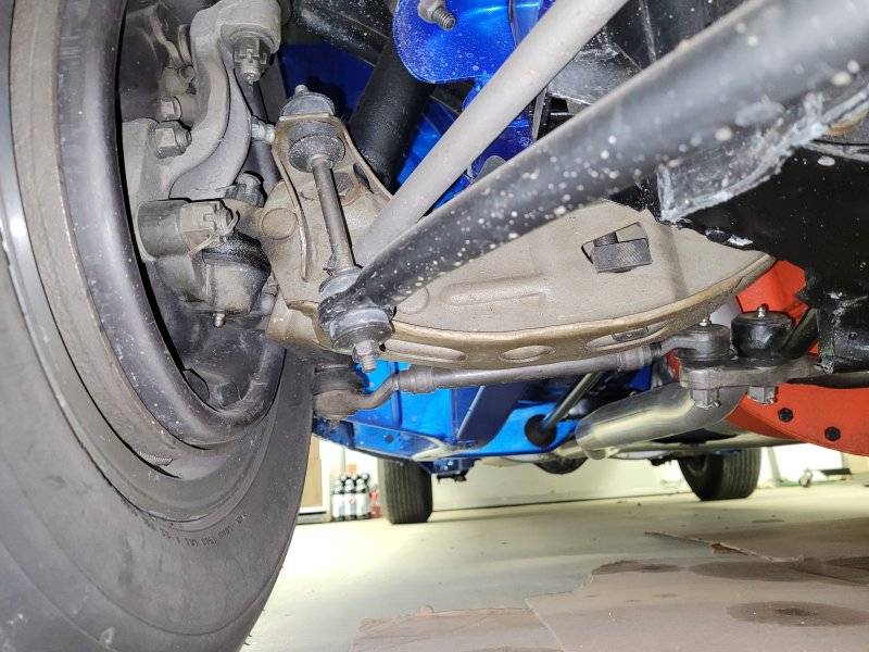

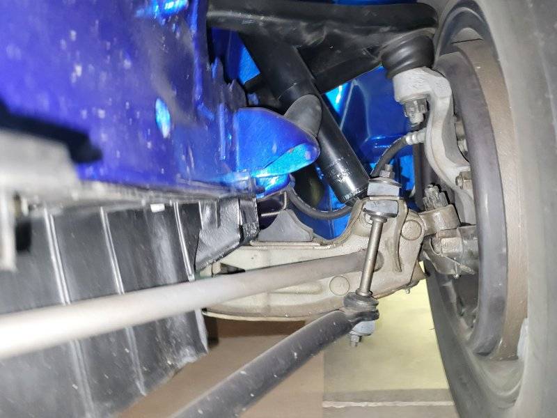

Lighting.. flash... no flash... here's two fresh shots just taken 6+ years now since the front end parts were done and 4500+ miles of driving. I live on a gravel road to boot...
All the crap on the sway bar is mud and water spots from my son driving through someone's pool backwash running down the street.
