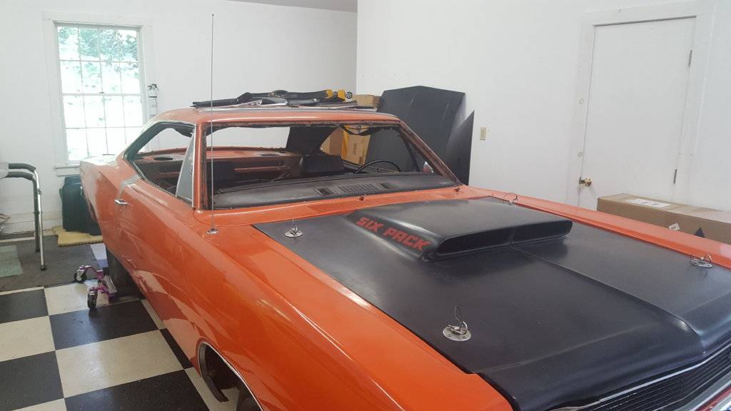

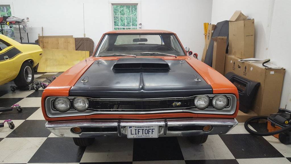

Can someone please post a pic of what they KNOW to be correct positioning for the laynards on a A12 car, just got my hood finished and I want to get the laynards in the correct rivot spot and also if the go across 9-3 o'clock or vertical 6-12 o'clock, thanks guys
These are pics of the original hood on my A12. As you can see the orientation here is 3 o'clock for the right side and 9 o'clock for the left...
Yup side that is closest to the scoop on all four......pics above are awesome visual reference!
View attachment 523150 View attachment 523151
Grandy I love how bad the original hoods fit....it's awesome in my book! You can see the gaps and it just shows ya how these cars were when new! Love original stuff!
Oh definitely! The right fender has been knocked around a bit so the fit on that side is even worse than usual but to what you stated, the fit was pretty crappy right from the jump and that's the way it will stay! I love original stuff too man...
