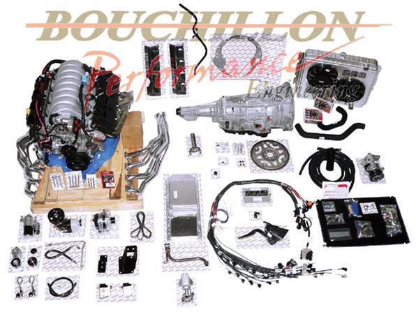

Found a link to a swap.. http://www.hotrod.com/articles/ccrp-0905-hemi-engine-swap-guide/
And picture of the parts mess. I mean parts needed.
