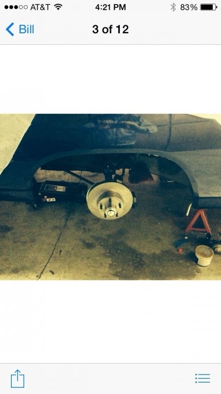

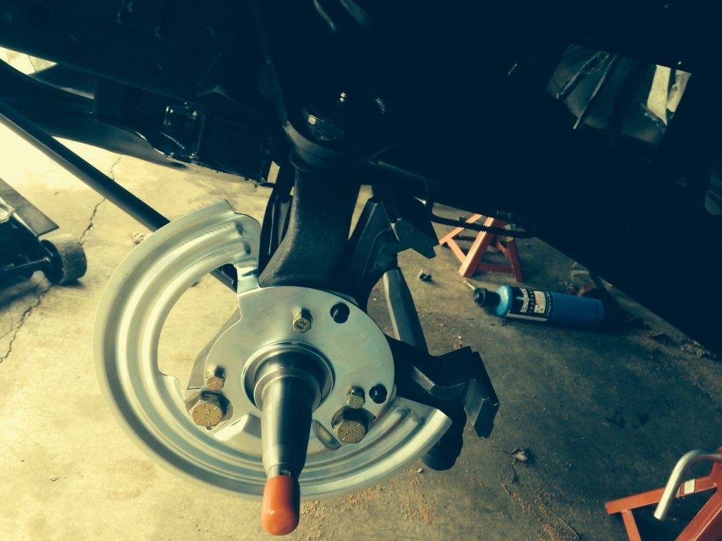

Making progress. Ready for disk/caliper.
The only question is calibers in the back or the front. The only answer could be which does the brake hose fit better. They can be run either way. I mounted mine on rear first then finished with them forward, but I do remember why I changed them(5 or so years back). They did not interfere with the sway bar either way.
Don't you love how new rotors look!
