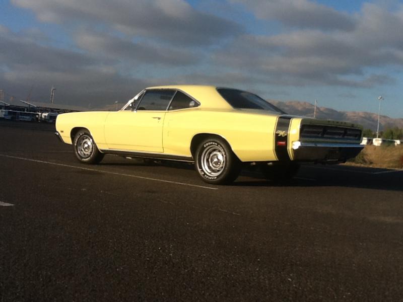

​​I'm looking to change the wheels on my 1969 RR from 14 Inch to 15 inch. I would like to go 15x8 all the way around with 60 series tires. Will this work for the front?
15x7 is probably the most popular front rim width, but some are running 8's. 235/60, 245/60, or 227/70 all work well depending on the height you are looking for. 15x8 with 275/60 is popular on the rear.
