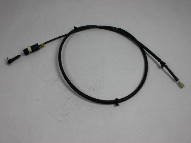

Some brief details on what is needed is the cable, corresponding brackets, kick-down lever, and spring from a 1994-2001 Dodge Ram 1500 or Dodge Ram Van (These are sourced from a local pick and pull and are priced cheap. I paid $20 for all this).
The next items needed to connect the new cable to the carburetor are a Holley 20-7 Throttle Adaptor, Edelbrock 8018 kick-down cable stud, Bouchillon Performance kickdown cable bracket (mounts kick-down cable under throttle cable on throttle cable bracket), one standard length 1/4 Coupler nut, and lastly one 1/4 bolt that threads into the coupler nut.
Below are the pics of the cable, lever, and spring and of course the video.

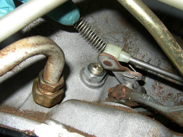

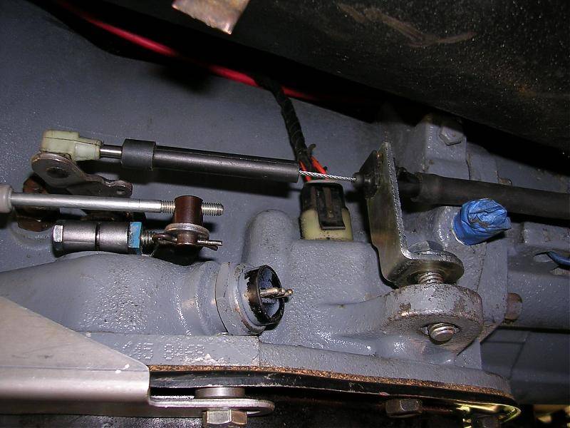

In the next photos you will be able to see the bottom bracket and the last small bracket which is attached on the bell-housing ear of the donor vehicle. The small spring which retracts the kick-down lever arm is also attached to this.
Now explaining how this all bolts to the carburetor and transmission is a little difficult with text and pictures, so please reference the before mentioned video in the link below. Please let me know if you have questions and I will do my best to answer them!
View attachment 1396009View attachment 1396010
