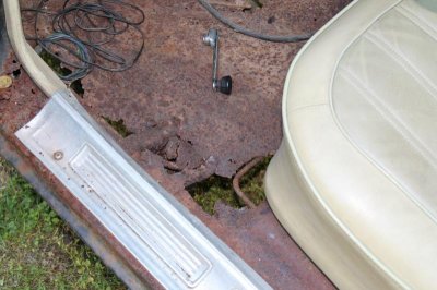

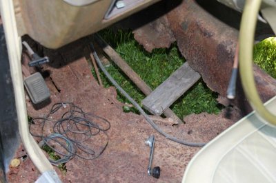

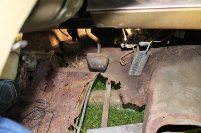

Here are some pictures of the driver's side floor pan...
Even with the big hole, the floor support seems to be solid as a rock. I've sat in the car a number of times and I don't feel any give in the floor.
Anything I should know about cutting out the floor pan? Bracing, what to avoid, etc...

buy a set of blair spotweld cutters
and go to town..
i would be hoping that the torsion x member isn't swiss cheese like the floor is.
you will find out soon enough
after the floor is gone...

My dad has a plasma cutter and a grinder I can use. But I think that crossmember is in good shape, but if it was in need of replacement; how hard would that be? Would I need to take it to a frame shop, or would that be something I could do?
I have a 72 Charger I could pull it from too.
once the floor is out, it is easy to get to.
no need for a frame shop.
if you are taking off metal from a donor car,
you will end up needing those spot weld cutters or at least a good drill bit.
the cutters will do a neater job.
You can do it. You will need to get the body square and level before you attempt that on stands using a long bubble level. Also look at your inner rockers. They will require the body be braced.

Judging from your photos, it looks like you're going t need as much floor as you can get. Maybe new or better shape floor braces, and I would almost plan on replacing the torsion bar cross member. At this point, it might be easier and cheaper to replace than repair.

You mentioned you have a used trunk floor and quarter sections from another car, and they need "minimal patching". The labor for removing and repairing those parts will probably exceed the cost of new parts. Judging by the condition of the floor, the inside of the torsion bar cross member is rotten and thin, if not eaten through by now. Where the driver's side frame rail joins the cross member is probably toast, too. Is there swelling around the spot welds of the shock mounts? Remove the front wheels and check the top of the frame rails where the upper control arm is mounted. It's like a tray that holds dirt and crud. Make sure it's not eaten through or so swollen between the layers that it needs to be cut out and replaced.
Your left rocker is shot and so is the lt. hinge pillar. Very possibly the inner rocker is eaten away also, where it joins the cross member. If you can, trim away enough floor to determine how solid the adjoining metal is. Peel away the floor pan above the cross member and dig the dirt out of it. Remove the dash assembly and heater box, seats and all interior trim. Pull the gas tank out, drivetrain too if it's going to be rebuilt.
I'm not trying to discourage you from taking this on, only trying to enlighten you so that it doesn't end up being a dream you dump lots of money into that exceeds your finances or ability. Good luck!
