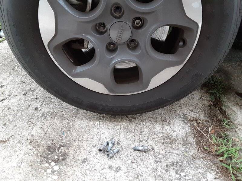

Surprise #1- lug bolts.
Yep bolts. Totally did not expect that.

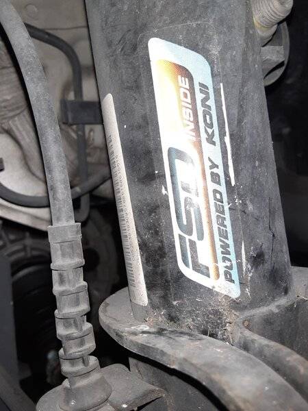

Surprise #2- "Powered by Koni" strut label. That's cool. have to assume that's OEM.

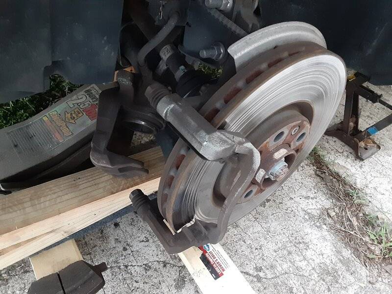

Surprise #3- there's a "caliper cage". Also holds the pads. ??? that's knda' odd.
Surprise #4- rotor is "bolted" to the hub with a totally non-standard, tapered, long shouldered hex set screw- WTF?? Bet dealer is only source for lost or broken and $$$$$. Don't like that idea AT ALL.
Surprise #5- caliper "cage" traps rotor and is bolted on TIGHT.
No room to get torque multiplier on end of 1/2" ratchet.
Wonder what the torque spec is.

You don't really need the bolt in the rotor it just helps for assembly at the factory.
*I just put it back in with never seize, they last surprisingly well.
The cage bolts likely have thread locker on them.
I'm sure they are pretty tight but not torqued as high as you might think.
Most of the guys at the Jeep shop where I worked just used a 3/8" air ratchet to r&r the cages. Not super-high torque at all.
Yes, anti-sieze on the hex bolt! Get the threads, AND the underside of the head flange!

Yes, they all have them. Take the cage off. You just need a swivel impact on an air ratchet or 3/8" impact. Probably a 13mm. Sometimes they are hex.
It can be hard to see how much pad material is left. 2-3mm is usually time to replace but if you're getting new ones you need to replace or cut the existing rotors. Hard to tell exactly how deep those gouges are but they look kinda bad, not sure if they can be cut safely or not. No one cuts rotors anymore though.
If you are changing rotors, they can get rusted on so spray some WD40 on the mounting face before trying to wrestle them off. Sometimes they are bad enough where you have to beat them off with a BFH. If you're getting new rotors and they're stuck just hammer them off. Make sure to clean the hub mounting surface face with a wire wheel.
Bolt heads for the cage are 16mm.
Awfully big, I thought.
Had to spray penetrant and beat hub area plus use pry bar to get rotor free.
I knew it was gonna be trapped by that cage, but I had to see. Sometimes you get lucky.
