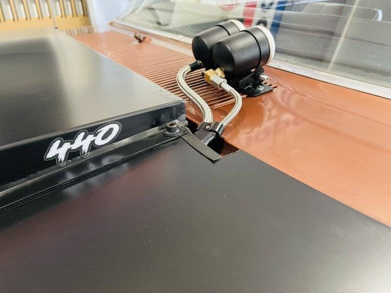

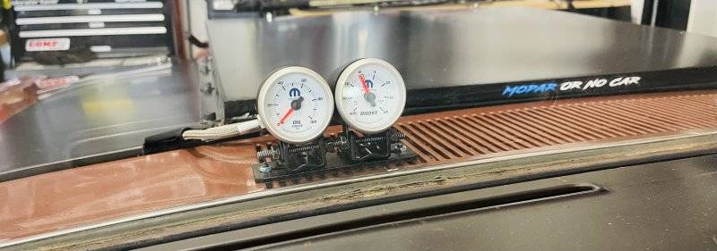

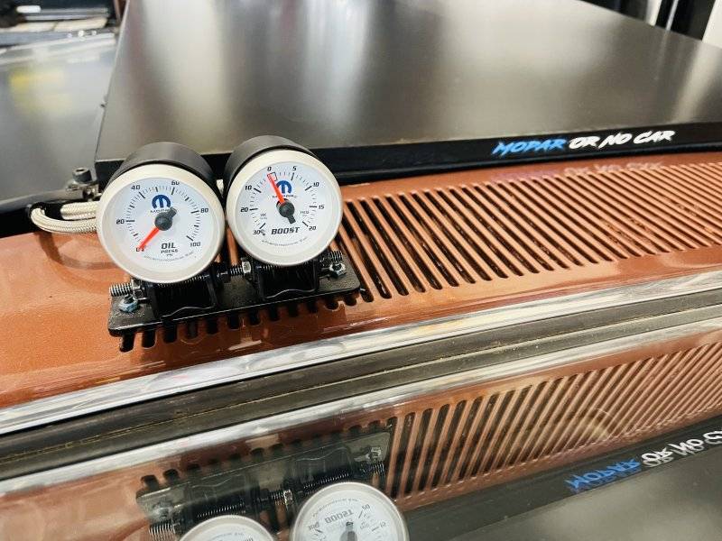

They’re not for everyone - but I like the nostalgic look of cowl gauges, and I like being different and unique. Just about finished up - some finishing touches needed yet.
Took some small threaded rod and some small round stock and welded them together to fit between the cowl vents - then twisted them 90 degrees to make the plate flush and bolt it down. Plate has a felt adhesive padding underneath it. Welded gauge cup mounting tabs to the plate and bolted everything together. Hood is a second hood I’ve already cut for hood scoop so didn’t bother cutting room for the braided lines.
Took some small threaded rod and some small round stock and welded them together to fit between the cowl vents - then twisted them 90 degrees to make the plate flush and bolt it down. Plate has a felt adhesive padding underneath it. Welded coal cups to the plate and bolted together. Hood is a second hood I’ve already cut for hood scoop so didn’t bother cutting room for the braided lines.

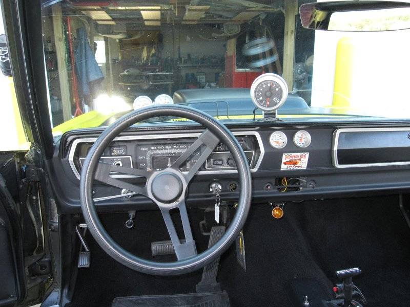

I have had mine since 1982.
