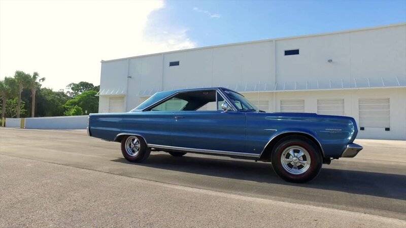

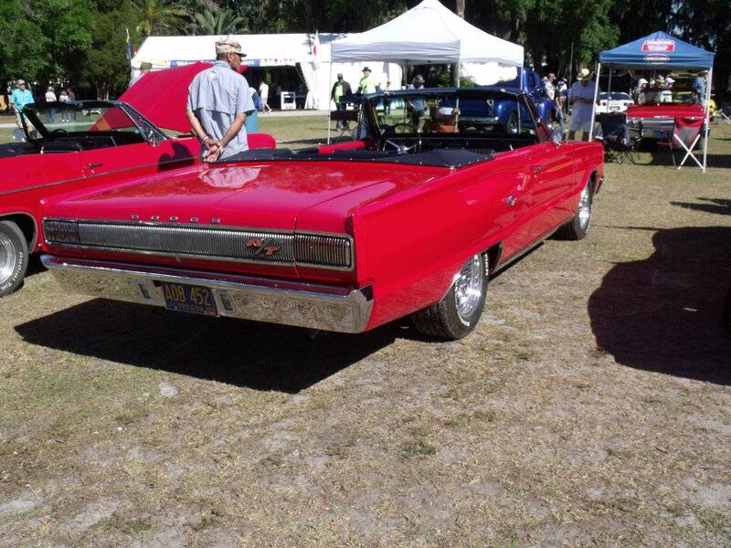

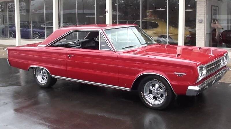

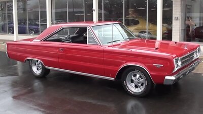

Most of the 67 GTX's on the net have Magnums but I found a couple photos. They look good.
