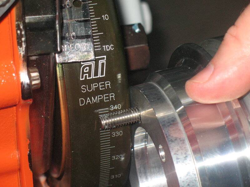

I had the same problem when I installed an ATI Super Damper on my last 496. The damper was 0.625" thicker. I resolved the issue with a new billet lower pulley and spacer from March Performance.
If it is an ATI damper then you need shorter pulley. The Doty pulley fits with an ATI damper. You need to post a picture or tell us which damper it is since it is possible that you have some other problem.
I ran into that problem with using the ATI damper. I got the shallow crank pulley from March performance that is supposed to be for a Fluid damper, but it was too shallow, so added a spacer, I think 3/8"? from Andy F
http://arengineering.com/home-page/pulley-spacers/
Then I had to figure the correct length bolts to use (1.500")
