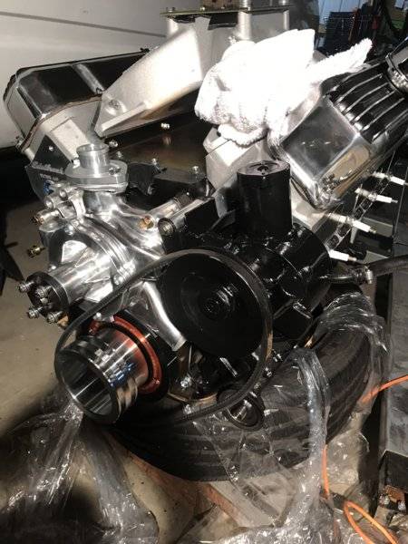

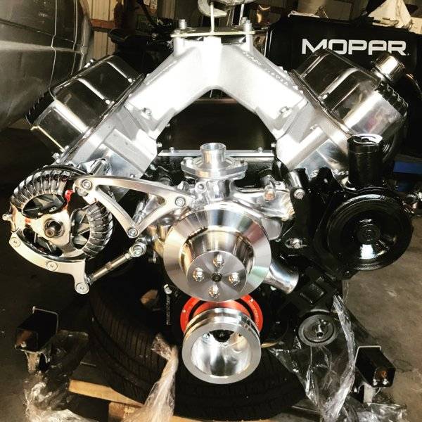

Gents,
Reading a post about balancers, Pulleys etc the other day got me thinking. On my stroker the eagle crank (4.25”) has a Hemi flange (8 bolt) on the rear, uses a Hemi balancer and Hemi balancer bolt. The crank pulley I used from 440 source bolted up fine and seems to be ok but I have not ran the engine yet and it was listed for use with 440 engines. Just wondering if it’s ok to run like that or should I be looking for a “Hemi” pulley thanks in advance.

Pulley? Scmulley, oughta be fine; they’re not balanced like the balancer. IMHO
That’s what I figured but i didn’t know for sure and figured I’d check with the experts here for peace of mind.
How is the belt alignment?
As in, are the pulleys in plane with one another?

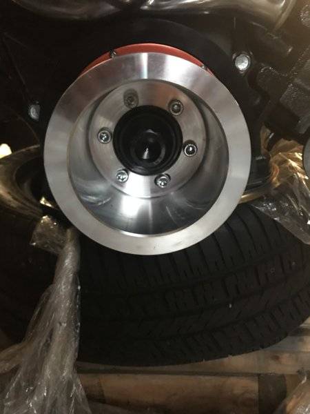

Also if you guys notice in the first picture the pulley bolt at the 5 o’clock position the hole is more of an oval shape while the rest are regular circle. Am I missing a washer or something there?
My guess is the hole got drilled like that accidentally.
Maybe a glitch in the program that makes the holes?
I’ve never messed with a HEMI pulley, so maybe there’s more to it that I’m ignorant of.
The main thing is to have the pulleys aligned as perfectly as you can get them.
As long as the pulleys are at zero runout (within a few thousands), you are aligned and you have the correct belt width for the pulley groove, you are good to go

Not sure exactly what you're holding it on with but those allen caps wouldn't be my first choice on an aluminum pulley. I'd definitely use grade 8 or better bolts with attached "spin" washers so you can torque properly. You did torque them, didn't you?
Yes, that’s the bolts 440 source recommends so that’s what I used.
Yeah, I got "learnt" about the two slightly different bolt patterns on those with all my engine swapping escapades. :)
If you add a washer only there it will put it slightly out of balance. I'd use them all or none at all.
