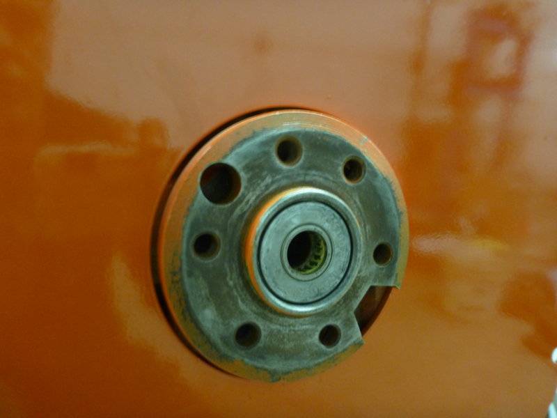

As Cranky said... Cut 3/4" off the end of the input shaft and install a roller bearing in the flange bore. You'll see on mine I have a standard trans crank and pilot bushing, but my numbers match trans had the input shaft cut, by me, back in 1979 to install behind 440 I put in our old Fury II that was an automatic's engine. Needed the bearing to make it work again as input shaft not long enough to reach the pilot bushing.
View attachment 676751 View attachment 676752

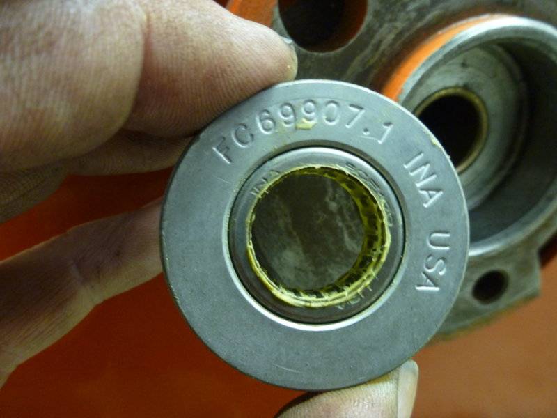

I'd be pretty certain the bearing I showed above is the same.

I put a new bushing in the crank and it went in fine. We also put the Dakota roller bearing (from Professor
Ehrenberg, yes) into the recess in the crank for the hub of a torque convertor for good measure, too.
(I had fetched the roller bearing in advance, figuring the crank wouldn't accept a bushing.)

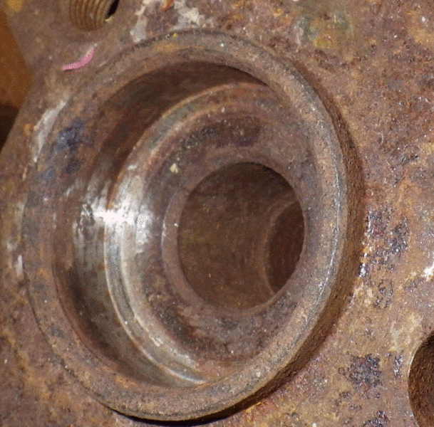

440 auto crank I have ………………….
dims on this crank require the green bore area to be opened up for the STOCK size bushing. Depth is fine...……..

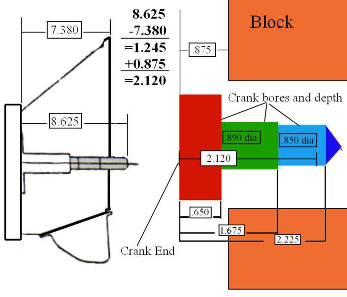

Then too, way back, I had a '66 383 that just had just the center bore and needed to be drilled for diameter and depth. Same as the example 2/3 down this page before the bearing was available........
https://www.bigblockdart.com/techpages/4sptech.shtml
