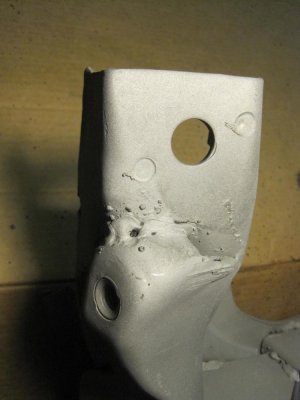

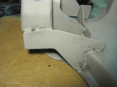

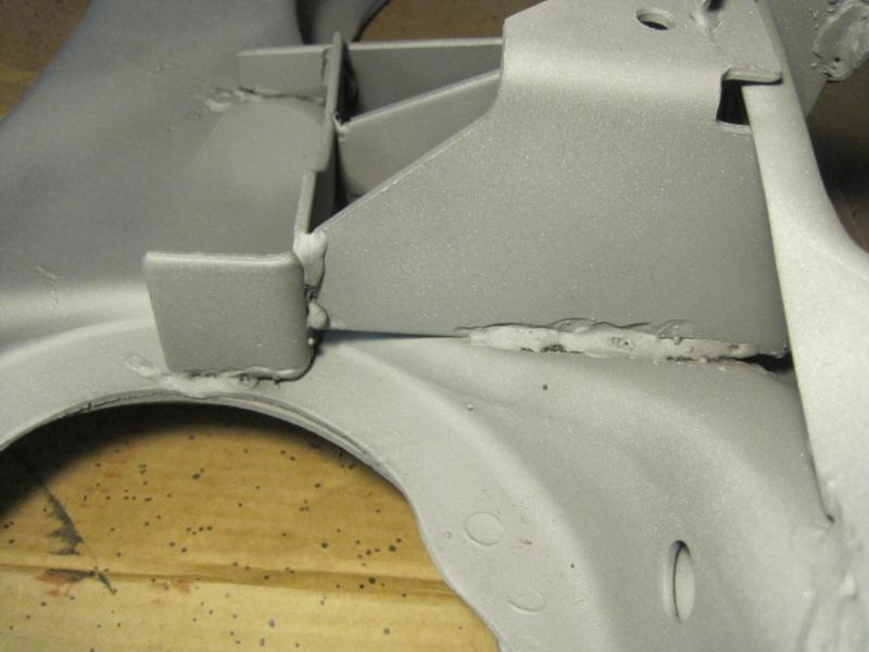

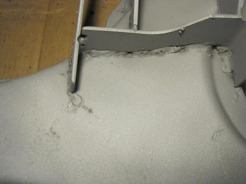

Well, I'm sure glad I had the K mineral blasted. Thanks to all of you who posted to my earlier thread. What couldn't be seen before the stripping was the poor quality of the welds. Is this really how these pieces left the factory?
The work around the steering box bracket was the worst. There's slag thrown everywhere. Some of the loose stuff pried off.

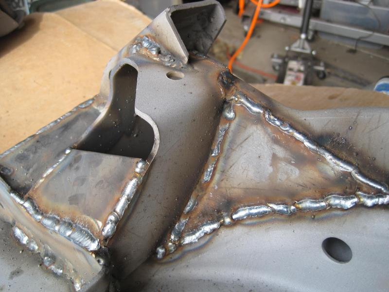

In any case all the joints are going to be welded on both sides and inside the brackets where the factory didn't weld. It didn't get a reinforcing kit but the extra welding will help. And I have extra scrap metal to fab reinforcement plates.
Yep, that's the factory welds!!
Quality control wasn't a big priority in that department I guess.
When they say they don't build them like they use to, I usually say, Thank god!!
Yep, those look like my welds. Sure they look crappy but then again, they've held up this long...
Sonny used to think:...THIS CAR HAS BEEN HIT!....but no, just factory welds from the "high school kids hands":iamwithstupid:

When I was right out of high school I worked at A.O. Smith in Milwaukee. They built a lot of car frames for Ford and GM. I had 1 week of training and they let me loose on the Corvette line and we stick welded everything. I learned to hate piece work and didn't work there too long. That's just the way it was back then.
While it may not look "Pretty" to you, it has worked for the last 40+ years, and on millions of cars. When working on parts in MP (mass production), there is not time to make it pretty, just workable to specs. When was the last engine you heard of falling out of the car? If you want to have it re-welded to make yourself comfortable, by all means, do it. But, it has worked just fine all of these years.
Thanks to everyone for their input. And yes 69Bee i understand what you're saying. With today's rebuilt engines easily putting out 600+ ft-lbs of torque and wide, sticky tires and HD suspension components, all combines to put more stress on the chassis. So I might as well reinforce the K and add subframe connectors while everything's apart.

I've cleaned up those welds and slag on every k-member I've restored and powder coated ... and shake my head every time. :D I wouldn't have lasted very long at the factory either.
These guys did wire feed stick weld, a messey inaccurate method. It was strong but they did not care about spatter from welding since nobody used gas to surround the welds.

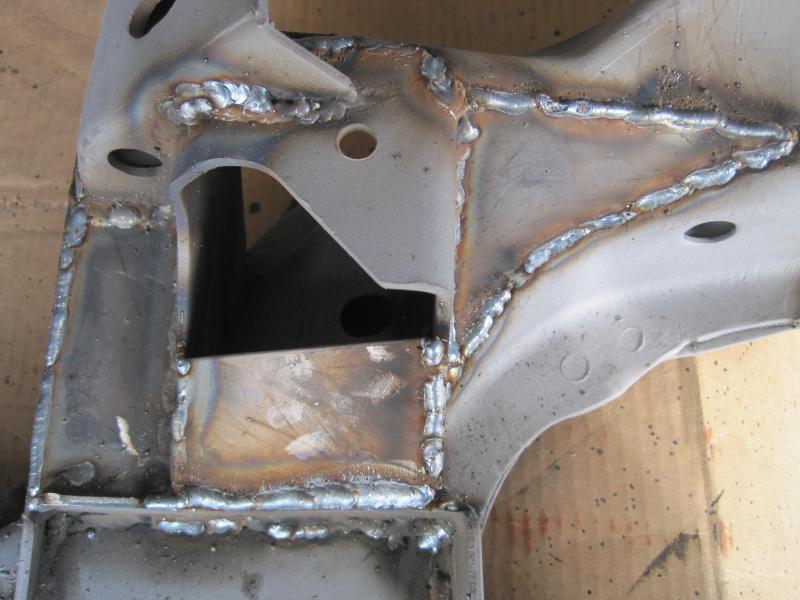

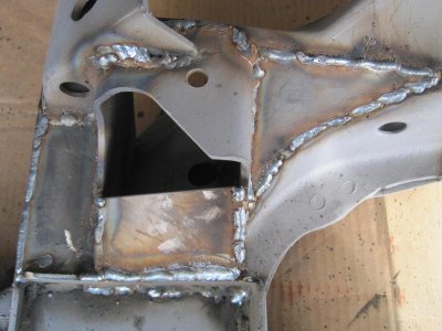

Started Project Overkill yesterday. The steering gear bracket is sturdy enough but there are two openings under the motor mount that I wanted to box in and also the large triangular opening below where the third steering gear bolts to.
Reinforced the driver's side motor mount while we're at it.
