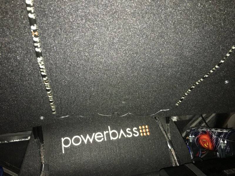

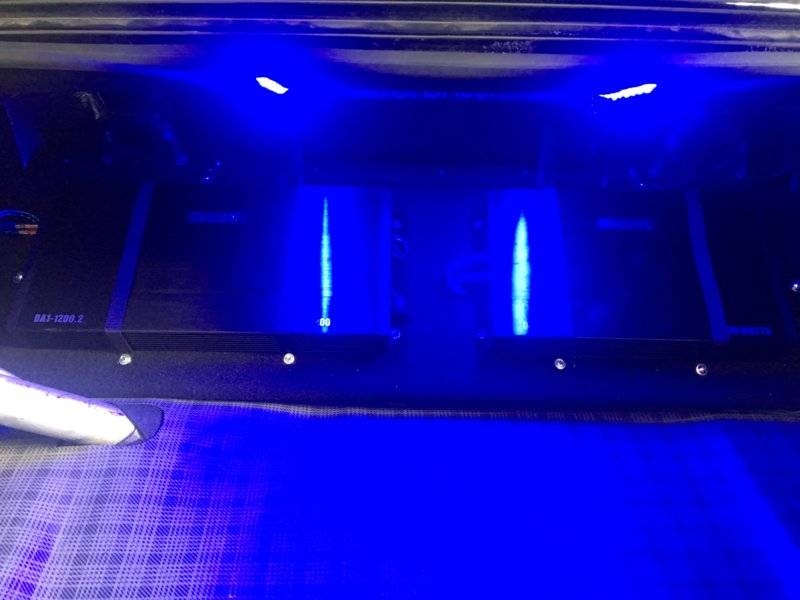

US.. here’s a pic of baffle. It’s not a great pic. But I took a large piece of industrial thick cardboard, measured space and cut to fit right behind trunk lid. Drilled and screwed right to package tray. I did insulate and cover with the thin black auto carpet. Glued and small stapled. I’m still tidying up the wiring.
As far as the wiring. I completely retired entire car with Ron Francis kit, new alternator (one wire) so that was the time. Amps are in the trunk and amp wires run while all apart so much easier. If you install amps you’ll have probably 4 gauge wire to run to big fuse and to battery plus the remote wire which comes from stereo to the amp(s) so when you turn stereo on, amps come on too. I’m running a 1000 watt 4 channel amp for main speakers and 2 channel 1200 for subs. Plenty loud and crystal clear. More power better. That way you’re not trying to get all you can out of your stereo. Plenty of power to spare. Now, if you push the limits of amps, sound will be bad and things will break!
