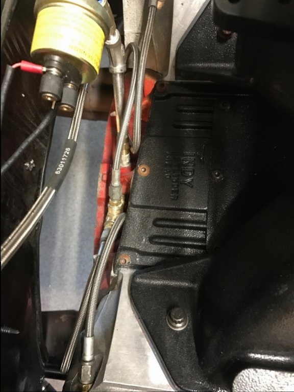

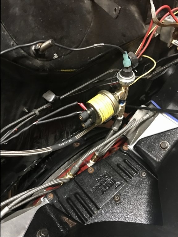

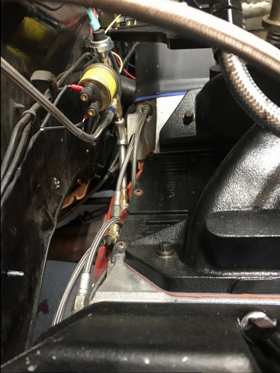

heres my setup on my indy heads.
As you can see they are oiled from the second oil plub in the block 1/4" I use one direct oil pressure gauge, one led oil pressure gauge and one low oil pressure light gauge. Hope this helps.
