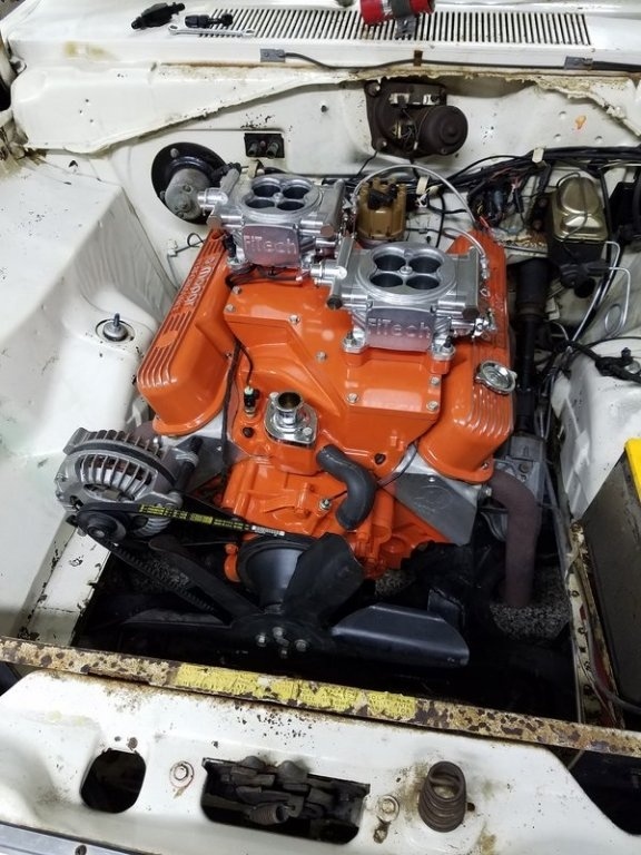

I have a 500 stroker in a 62 dart maxy clone thinking of replaceing the carbs with throttle bodies and injectors has anyone done it and how complicated is it?
Should be as simple as a dual quad FI setup. With the latest FI kits should be a simple PNP.
I'd love to see the final result! Should be VERY cool.
I'm following replicaracer43 thread (on FABO) re: setting up Fitechs on his 408 crossram. Really cool stuff.
http://www.forabodiesonly.com/mopar/threads/fitech-crossram-project.358502/page-2
Richard Nedbal did a conversion where he put injectors and fuel rails inside the cross ram. I don't remember what throttle bodies he used but you could use a set of gutted carbs if you wanted a stealth look.
This would be a very cool set upand will run great. I would seriously use the controller from Holley and locate the Injectors inside as well. Richard Nedbahl used generic throttle bodies in the swap.
Is Rich on here? We used to be in the same Mopar club years ago.
I checked some of the am throttle bodies and I was going to go with a megasquirt for brain its the tb's are expensive wonder did they make any oe ones I can get from a yard?
A buddy is running efi on his maxy clone 64 Savoy. I believe he started with 2 FAST TBIs and a low end controller ("self learning", minimal adjustment capability). He switched to Megasquirt this summer for hopefully better tuning.
