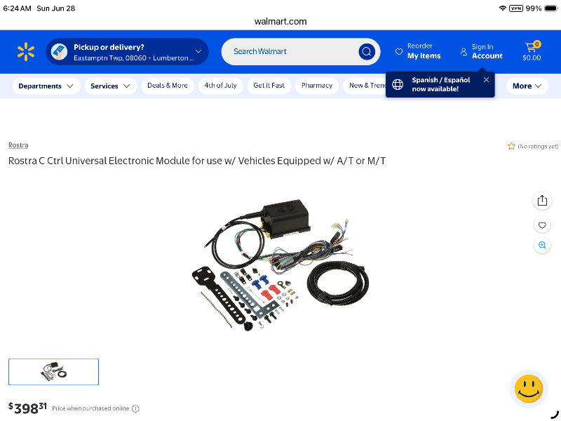

Here is one that should work: Rostra C Ctrl Universal Electronic Module for use w/ Vehicles Equipped w/ A/T or M/T - Walmart.com
Better/safer than an after market I would think. What does the system cost?

I've installed the same system and post two on my stroker roadrunner and on my Chevy pickup it's a universal install very simple very easy take your time make good connections you just have to put in a electric generator for your speedometer which is 80 pulses or 800 pulses per mile I don't know it's any instructions I don't remember but it comes in the kit it's all in one

Thanks, I 'll look one up
