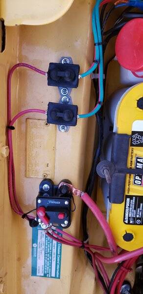

DAMN ELECTRIC FANS!! F'D AGAIN!
This is the SECOND fan motor that has burned up then locked up. Trips the 200 AMP main breaker. NO HEADLIGHTS, NO AC, NOTHING ELSE ON, so I don't see how my "fairly certain" theory that it was the headlights drawing too much power, especially w/the high beams on, and that caused a current drop and concurrent voltage increase to the fan, making it burn up...NOPE!
I can't understand how the wiring could be the problem.

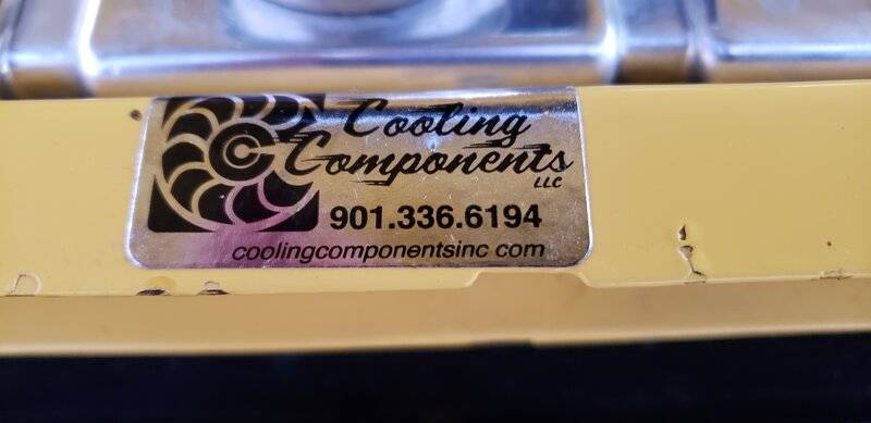

This is the fan manufacturer:
So now what? I barely have enough room for this fan and shroud setup and it's only 2⅝" deep. It works FINE right up to the point where it burns up...
"Hey Maverick, that's some of the best flying I've seen yet, right up to the point where you got killed"...

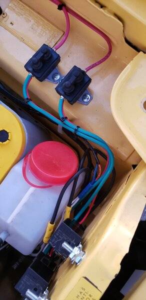

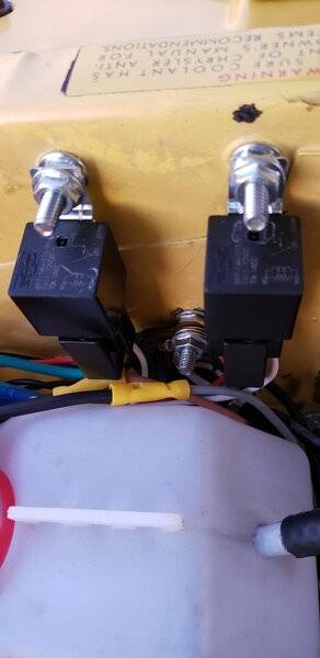

I can't even use a mechanical fan. Here's the wiring of my fan:
I think you could use a flex fan with a 1 inch spacer,I had a tight 3 inches and with the setup I have about 1 1/2 off of radiator. they also sell a 1/2 spacer but the back of the fan might be to close to the PS unit. I am using a shroud.
I know a 1" spacer won't clear the Wraptor from the experience with my wife's car, but I will be exploring any other options.
140 AMP alternator. The only things using power this time when this happened was:
Ignition system
Radiator fan
Dakota Digital gauges and DD fan control module, and all of the DD stuff doesn't draw much power.
I don't understand why one or both of the 30 amp breakers don't trip before the 200 AMP breaker.
NONE OF THIS SHOUD BE HAPPENING!

Do you have a photo of your fans? I could bring you the low profile dual fans from my Charger if they would interchange.
