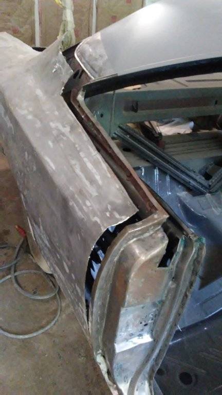

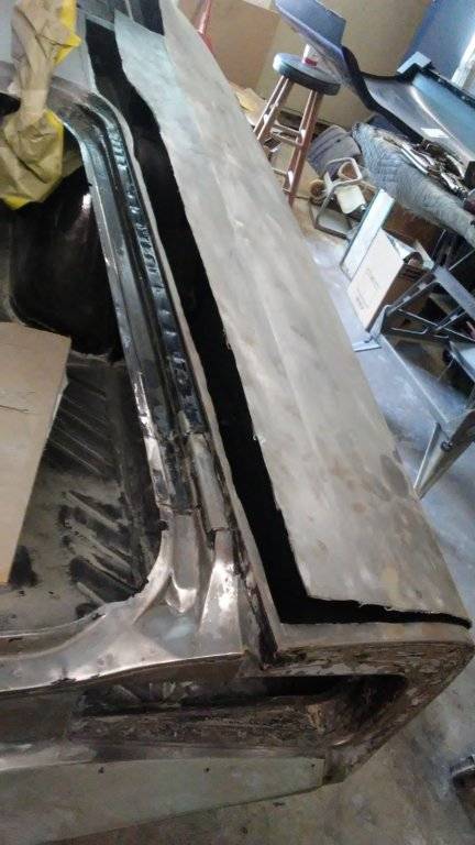

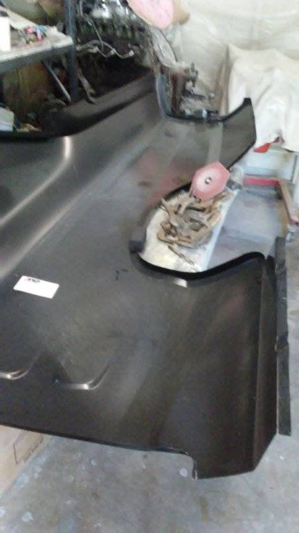

After having several " body guys " fill it full . And after paying to have front & rear patches both installed, doin it right this time !

I'd drill the factory spot welds & attach the new panel. That much splicing is inviting post cure shrinkage problems later on. If You’re going to splice, You should 'step' the joints.
Yes, did the driver side on my convertible last year - replaced it with a donor panel . . . it's in my build thread
Look closer. This is only an initial cut to get the bulk of material out if the way.

i just took one off that had been replaced before in the past
and what a mess.
the whole bottom edge was just put over the cut away original
leaving 2 layers of metal to dig away at.
and what a mess.
Eww. Sounds like time for a plasma cutter. Or, saws all. Lol
a lot of grinding away and spot weld cutters.
the plasma and sawzall will only get you so far
unless you like to really destroy things..lol
Spot weld cutter, hammer and chisel and grinder. Lately been welding the new panel on threw the cut spot welds. Yes I know you are supposed to cut the panel being removed and grind the weld smooth but I do not have a spot welder.

Thats the way I removed the panel - works great !
