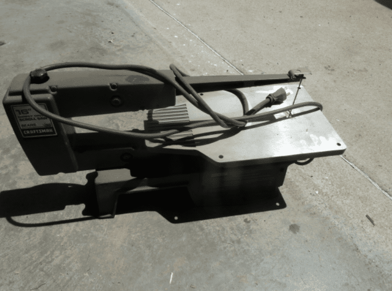

Need to cut a number of pieces of flat aluminum. Never owned or used one, but thinking of buying this one for a project I have going. How difficult is it to change blades?
Blade change is simple but, these are made for wood. Going to take some time to make your cuts. I cut aluminum on my table saw (carbide tipped blade), straight cuts only of course.

Yup, Table saw, skil-saw, router...band saw... That little scroll saw will do it but it'll try your patience..
IIRC you can get carbide coated wire "blades" for some models.
Those make tight corners in hard material much easier.
Safer saw with a metal cutting blade with the proper number of teeth for 3/16" material. Bandsaw is the cat's meow.

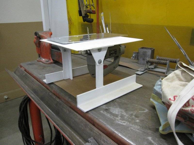

I made this little table to mount my jigsaw on, it has a screw on base plate so I remove it and with longer screws, mount the saw. Works great.
Mike
