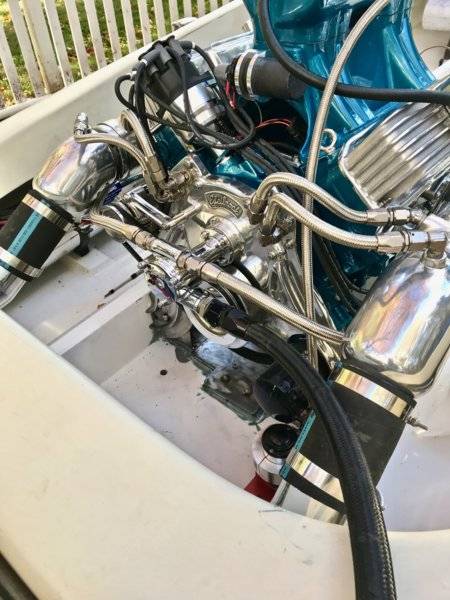

The larger sizes I like a low tack tape such as 3M Blue and clamp one end of the hose so I can keep tension on it and use a cutoff wheel with the mark in the middle of the tape. With stainless the trick is "not" to unravel the wire braid. The other toy (1968 drag-boat with a Mopar) has all stainless AN hose. It was worth the effort.
