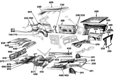

already have the bits..... and i know the actual spot welds are kinda random.... im not asking where EACH spot weld is..... im asking what parts are spot welded together and where each partis located..... something like this but for b body 1968....showing every body part
Rad support, inner fenders, inner fender attachments, firewall, cowl, inner rockers, outer rockers, inner wheel house, outer wheel house, quarter panel, tail panel, tail panel supports, bumper panel, dutchman panel, package tray, frame rails, torsion bar crossmember, floor pans.......everything? That isn't all of it. Are you building it or parting it out?

Well the picture you posted is about as close as you will get. Or you can look at AMD and their patches/panels and see what they are supposed to look like. But before you go and cut it up show a picture. Someone may want to buy the car as is. No sense on cutting up a car that could be restored. The picture I say was a post car. Not sure which one you are cutting up. But if it can be saved, save it.

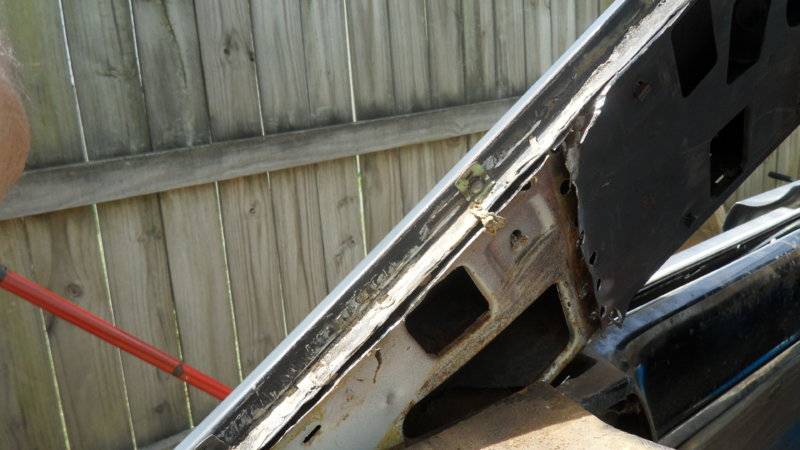

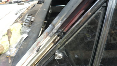

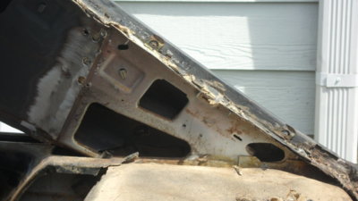

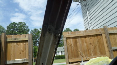

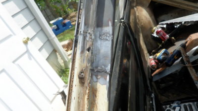

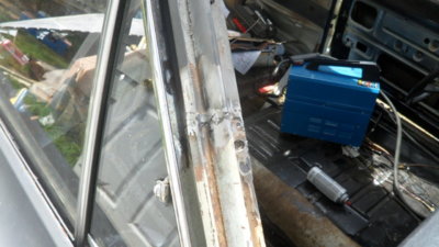

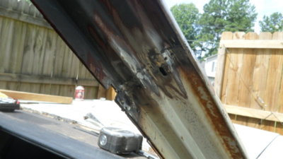

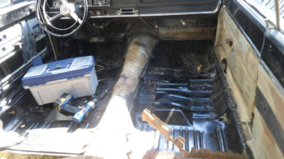

If you want examples of say a floor pan install I have some pictures of the braces and what needs to be cut out. They are my personal pictures Also I removed an entire roof from a 67 Coronet and put it on my 67 Belvedere. I cut the spot welds out that I needed to cut out and the roof came off like it would have from the factory. However I had to do some creative welding on the front pillar since I didn't want to try and reskin the old structure. There are seams that you can find and usually spot welds that are in each of those seams. If you just use an air hammer I bet you mess some sheet metal up. The proper way is to drill out the spot welds. But only through one panel. Don't drive it home through both panels.
SAM_5974.JPG SAM_5973.JPG SAM_5971.JPG SAM_5975.JPG SAM_6024.JPG SAM_5966.JPG SAM_5967.JPG SAM_5968.JPG SAM_5969.JPG SAM_5970.JPG
