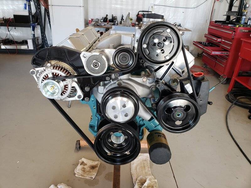

I have the March Revolver and al I can say it was straight forward, no leftover bolts washers or spacers. The only thing I would have liked to have seen would be an automatic tensioner instead of the spreader bar. I'm really disappointed that its hidden from view...but I only paid a grand, I think it retails for $2800

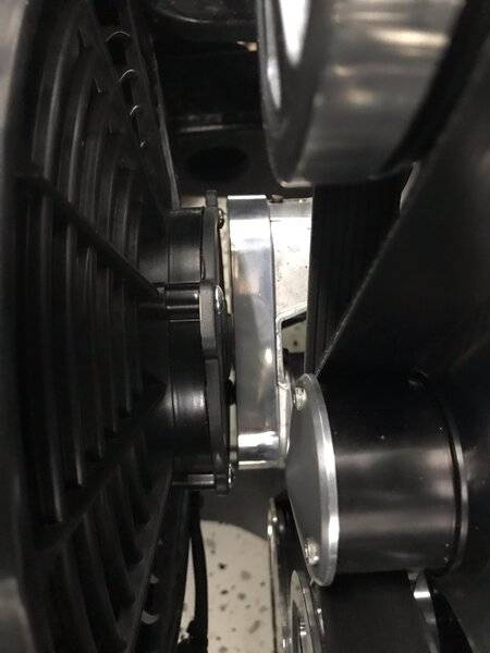

How much space do you have between pullies n radiator for e-fans n shroud?
I have a SD Concepts system. Comes with mounting hardware only. Therefore very reasonable price. You must purchase your own accessories, p/s pump from 95 grand Cherokee, 140 amp alternator from 95 Durango, a/c compressor from 95 Durango, belt tensioner from 6.5 chevy diesel and w/p that will work reverse rotation. Everything lines up perfectly. Only problem is space between pullies and radiator for e-fans n shroud. Huge pain in that area.
Maybe an inch 1/4, had to take the fan loose and hold it tight to the radiator when I was lowering the car down onto the K member. It barely cleared the ac pulley cover

On the GTO that is a BIG problem! The Wraptor pushed everything forward, towards the radiator, and I don't know if or how much thicker the radiator is in the direction of the engine (It may not be any thicker than the stock radiator) but the stock fan was pushed too deep into the fan shroud to be effective, and that led to the dual electric fan option (which is kinda good in and of itself).
The GTO has a tiny bit more space than this, but I had to do without the tensioner decorative cover it was so tight:

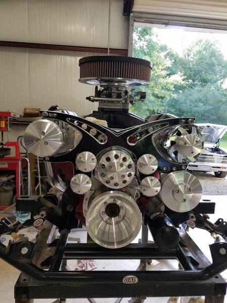

SD Concepts system
Great people there, and their cap and girdle system was the ONLY one I was going to use until I lost my mind and decided a Bill Mitchell aluminum block would "save me the money" I'd have to spend for reinforcing a block that would be running towards its upper limit of power output...
Anyway, without a doubt that SD Concepts serpentine belt and accessories system is BY FAR the least expensive way to achieve a serpentine setup, and if a component takes a poop, replacements are everywhere.

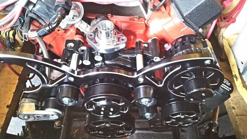

Well I was in touch with the mechanic who has been doing the work on my wife's GTO, and yesterday he had told me about the Wraptor throwing the serpentine belt off after he left the car running for about half an hour. Long story short, he had to adjust the spacing of the bracket that moves all of the pulleys except for the water pump and crankshaft. On the second redo, he made the ANGLE and the spacing of the pulleys match, by removing some of the washers. THAT did the trick! He just sent me a video and it looks great. Also, the Cold Case radiator, Cold Case dual electric fan and shroud assembly, and the Dakota Digital fan control module are doing a great job so far of keeping it cool.

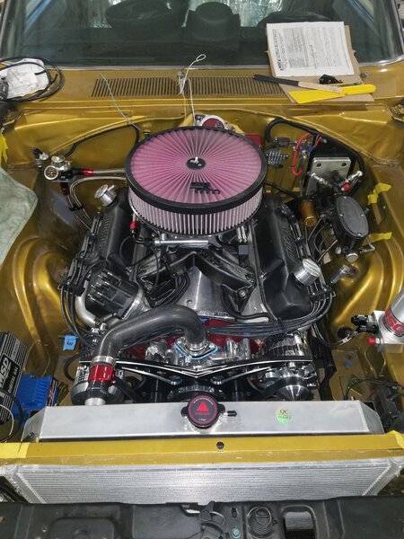

CVC Wraptor installation is well on its way on my Roadrunner! AC compressor still needs to be installed.
That’s a really well thought out package. Goes together easily too.
I was surprised to get that picture sent to me. The mechanic had some problems getting the rear discs and calipers installed, which prompted me to call Quick Performance, where I got them. He had to give them some measurements and they are sending some spacers machined to the specifications I need, no charge. Basically the Wilwood parts are rather generic, but I have had great experience with QP, and they knew exactly what to do. The Wraptor progress is because that was next on the "ever more boxes being checked off" list.
The backwards "C" space on the left of the picture is where the Wraptor air conditioning compressor goes. The billet hardware and dress up makes it something to be seen rather than hidden.

I decided to get a billet aluminum water pump neck that seals with an O-Ring.
I figured that would dress up what will be a focal point, and provide a great seal vs the flat gasket style.
