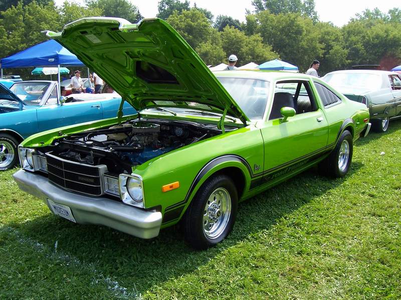

I have the 3.5" Welds on the front of my current Runner. It has a 27" tall tire on it.
I had these same rims on my previous Runner and had no issues on the street.
Now, I made sure I didn't do any corner carving with it, but with regular driving it was fine.
Even driving on the highway I was confident with it.

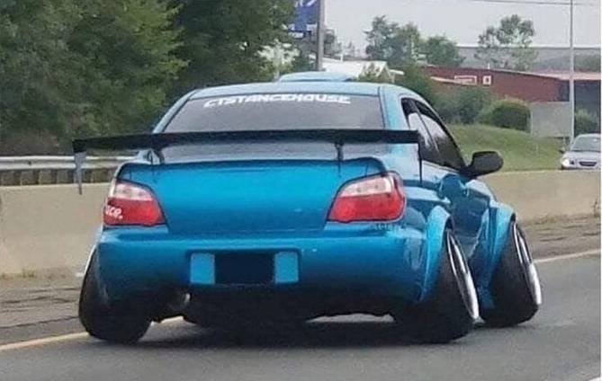

For looks, go this more modern route instead - looks way better and much safer !!!!
speaking as a car guy my entire life............ ^^^^^^^^^^^ that is by far the stupidest (most stupid?) sh*t I've ever seen done to a car; it makes me want to vomit
