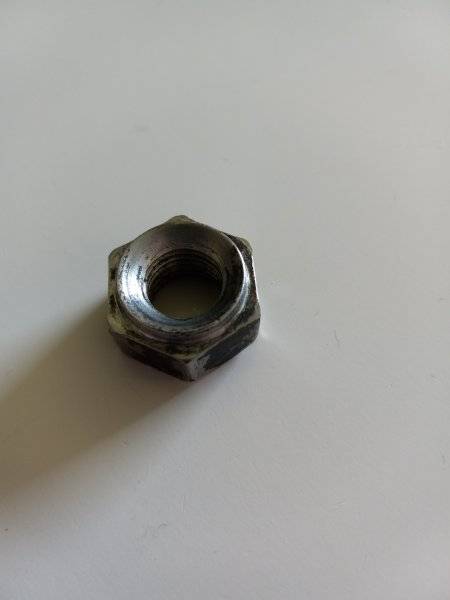

I had the power steering box rebuilt about 4 years ago now. It has been trouble free, until this year, I noticed a leak . Its a 68 Charger, and the leak is coming from the top, where its half dome piece is, with a screw and lock nut. The leak is coming right around the screw that has the nut on it. This looks like an adjustment of some sort, very similar to the flow bowls on holley carb.
Can I try loosening the lock nut and right tighten?
Thoughts suggestions ?

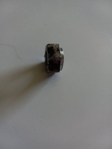

I took the nut off today . There was no washer/gasket but I did notice the nut had a flare on it ? Is this a newer style ? Maybe done when it was rebuilt 4 years ago? Or should I still have a gasket of some sort in there?
IF I do need this gasket any idea where I could source one ?
I am not familar with that style nut. Just make a gasket out of aluminum and try it.
