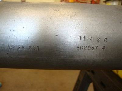

Is there a way to findout if the axel is the one that the car was delivered whit from faktory ?
As far as I know there is a very faint date stamp on the top of one of the tubes near the center, but no serial number that would match your vin.
Rears were never vin stamped etc....You can only go by PN and date for a dana 60...
Ok the date on the pic. November 4 -68 ?
Thankyou I did learn somethin new today !
