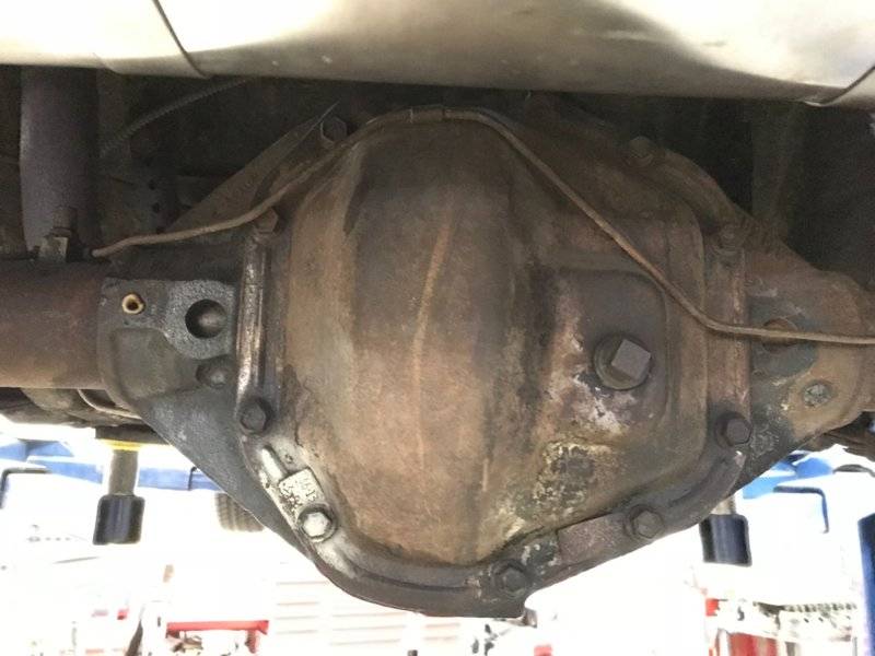

Get one from a Ford. The Tubes will be 3.125 in diameter so u bolts will be needed and also drill out the shock plates. The tubes are very thick, and you’ll need a very good mig welder to get penetration welding the bearing ends on. I did 2 Dana 60’s not too long ago, 1 for my 470 dart another for my buddies Duster 4 link and both were Ford Dana’s. Use a power lock sure grip with 35 splines and 35 spline axles and you have a really stout rear.

Look at the 72-79 1/2 ton trucks and 3/4 ton trucks.
