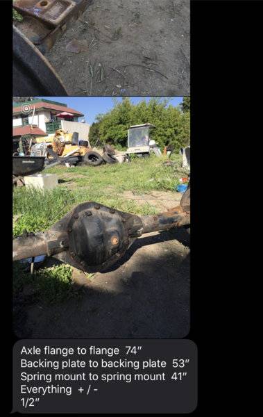

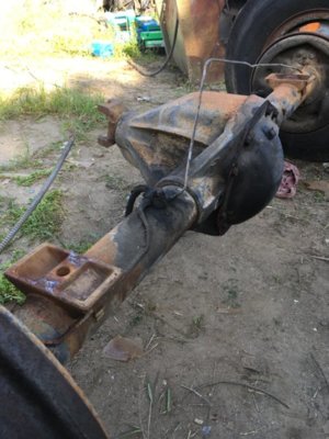

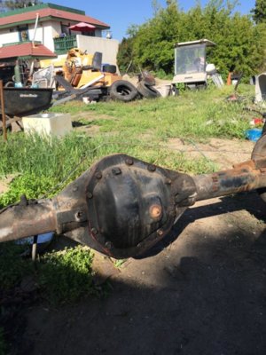

Hey guys I’ve got this guy looking to get rid of his Dana 60 and he said it came out of an RV. He texted me measurements and pictures. I’m wondering what I need to do to get it to fit like a factory for a 68 b body

So this is a Dana 60 and I can get it for $100, the guy has is lying around. Is it worth it?
Do you know the gear ratio? Motorhomes often had 4.56 or 5.10, but if you're lucky it could be a 4.10. If it isn't the ratio you want, add that cost in.
Making sure the whole rear is straight in the first place is where you should start...motorhomes have lots of weight and big torquey engines.
If you want a pinion snubber like the car versions had, the housing will need to be machined for one. You'll need to cut down the longer axle tubes and put on the correct axle ends, they can be had from Moroso for $100 https://www.moroso.com/c-e-shop-browse/97000/--9705/ Doing all the measuring, cutting and welding yourself will make the difference of whether it will all be worth it in the end.
You can see in your pictures that the spring mounts are on top, they need to be cut off and bottom ones installed https://www.ebay.com/itm/New-Mopar-...846781&hash=item443d1122b1:g:FdYAAOSwBLlU3Sjm Figure the cost for new axles, bearings, brakes backing plates and drums...

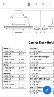

I bought a D60 TracLok from a member here only to find out ot has an odd deck height that I cant use. MAKE SURE TO VERIFY THAT!!!
It's not a series 3 or 4 which are different.
I'll probably end up buying an Eaton.
Dana 60 4.10 & Down 2.225″
4.56 & Up 2.420

I could be wrong but I don’t think that is a D60, look how thick that top main “rib” is.

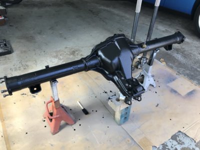

I was going to order a Strange but decided to build a truck D60 myself, a little cheaper.
