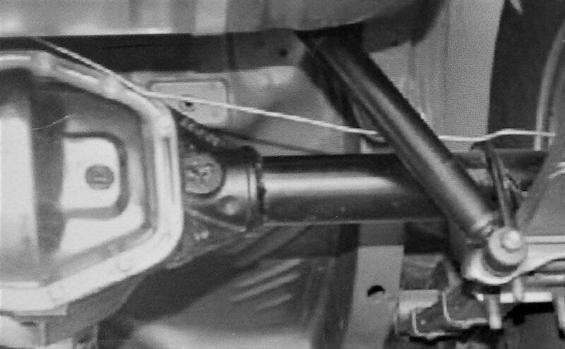

I have a B-Body housing less Main Caps.
Would caps from another Dana 60 fit? With or without machine job...
Thank you.
ATTACH=full]1170178[/ATTACH]
