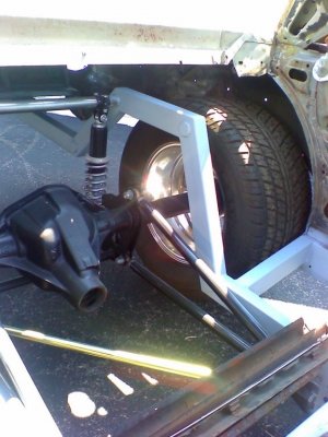

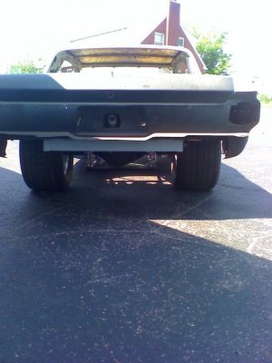

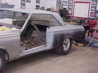

Seems these Days the S-60 is the way to go. When I did the rearend in my 65 Belvedere II almost 10 years ago I used a truck rear. You can make any backspace wheel work correctly with some simple math.
These rear wheels are 17x11 an have 7 1/2" backspace. I wanted the option of running larger Fatter wheels and tires with ability to also run stock offset wheels without the rear being too short and looking funny. Tires are 31.50x16x17 Hoosier Street Radials
