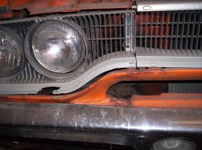

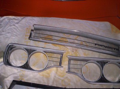

Does anyone sell, and has anyone used argent paint that is dark gray and has a metal flake in/on it? My 70 Road Runner grill is dark center and light around the edge. Its broken, and the one i have to replace it with is all light argent. Any help would be great.

Lots of luck..Only one company has the rights to the textuered dark argent paint...you can,t get it in a can...I looked around for about 4 months...The king of trim I think is the one..

Not the answers i wanted to see, but thanks for the input. I might try to come up with something. I just hate to put the light grill in and paint it black. Ill see if anyone else has any ideas. Again thank you.

Before U do something 2 crazy like shell out your life savings for a re-pop or paint it black, check O'reilys/murrays auto or an advanced I managed to find every color or rattle can trim color u can imagine,and they say chrysler duplicate colors right on the can,spraying light coats 12 to 15 inches from whatever u are painting and use as many coats as it takes to smooth it,and u should have a grille to be proud of when u are finished! The paint is by duplicolor,I found the exact mettallic paint u are referring to If u cant find it let me know I can pick u up a couple cans here and mail them to u!

Totally Auto has textured argent paint in a rattle can. I redid my trim on my '66 Belvedere II with it, worked fine.

For the light argent, I bought the Dupli-color light slate met BGM0540. It was a perfect match to the unexposed backside of my '74 grill and tail light housings. There are about 7 or 8 different shades of the silver Dupli-color and some have a little more sparkle than others.
Use Totally Auto... I was skeptical to do so, but after I did mine, it came out great ! you'll also need a silver tone color & satin-black as well.
