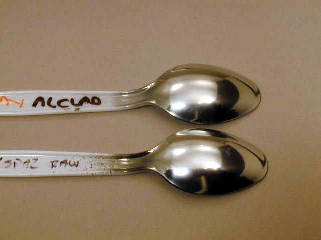

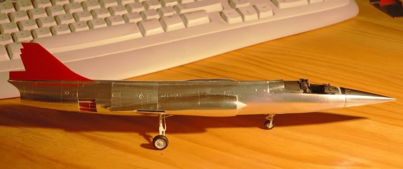

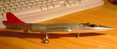

Go to your local hobby shop and ask for baremetal foil or Alclad chrome paint, both will work on a budget.
I'll just leave this here in case things change ;)

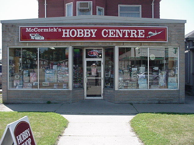

Easy as pie no problems getting it,I have it in stock as we speak. if you in London,On. come see me at 241 Oxford east between 10-6 pm M-F Sat 10-5 pm:blob1:D1.JPG
